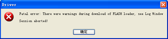

IAR6.4+J-LINK调试TMS470R1B1M的时候每次Debug都出现Fail error:There were warnings during download of FLASH loader,see Log Window Session aborted!导致失败,芯片上电后原来的程序可以运行。。急
Other Parts Discussed in Thread: TMS470R1B1M
  • 补充一下:我把板子的电源完全断开30分钟或者更长一些后,我可以正常使用J-Link调试下载,重复下载不到10之后,又会出现标题中的问题。

    感谢你的回复,我使用的是TMS470R1B1M的高温版本。
    以下是下载失败时的log
    Wed May 28, 2014 16:05:52: Loaded macro file: C:\Program Files\IAR Systems\Embedded Workbench 6.4\arm\config\flashloader\TexasInstruments\FlashSM470R1B1M.mac
    Wed May 28, 2014 16:05:52: Logging to file: E:\work2013\0hw\rcd6001\src\rcd6001b\cspycomm.log
    Wed May 28, 2014 16:05:52: JLINK command: ProjectFile = E:\work2013\0hw\rcd6001\src\rcd6001b\settings\rcd6001b_Debug.jlink, return = 0
    Wed May 28, 2014 16:05:52: Device "SM470R1B1M" selected (0 KB flash, 0 KB RAM).
    Wed May 28, 2014 16:05:52: DLL version: V4.50d, compiled Jun  5 2012 19:43:01
    Wed May 28, 2014 16:05:52: Firmware: J-Link ARM V8 compiled Nov 25 2013 19:20:08
    Wed May 28, 2014 16:05:52: JTAG speed is initially set to: 32 kHz
    Wed May 28, 2014 16:05:52: Initial reset was performed
    Wed May 28, 2014 16:05:52: TotalIRLen = 4, IRPrint = 0x01
    Wed May 28, 2014 16:05:52: Found 1 JTAG device, Total IRLen = 4:
    Wed May 28, 2014 16:05:52:  #0 Id: 0x3100E02F, IRLen:  4, IRPrint: 0x1 ARM7TDMI Core
    Wed May 28, 2014 16:05:52: J-Link found 1 JTAG device(s). ARM core Id: 3100E02F ARM7

    Wed May 28, 2014 16:05:53: 3456 bytes downloaded and verified (30.96 Kbytes/sec)
    Wed May 28, 2014 16:05:53: Warning:
    Verify error at address 0x00400082, target byte: 0x00, byte in file: 0x0C
    Verify error at address 0x00400083, target byte: 0x00, byte in file: 0xDD
    Verify error at address 0x00400170, target byte: 0x00, byte in file: 0xD1
    Verify error at address 0x00400171, target byte: 0x00, byte in file: 0x0F
    Wed May 28, 2014 16:05:53: Warning: Too many verify errors, only the first 200 are displayed
    Wed May 28, 2014 16:05:56: Fatal error: There were warnings during download of FLASH loader, see Log Window   Session aborted!
    Wed May 28, 2014 16:05:56: Failed to load flash loader: C:\Program Files\IAR Systems\Embedded Workbench 6.4\arm\config\flashloader\TexasInstruments\FlashSM470R1B1M.out
    Wed May 28, 2014 16:05:56: Failed to load flash loader: C:\Program Files\IAR Systems\Embedded Workbench 6.4\arm\config\flashloader\TexasInstruments\FlashSM470R1B1M.flash
  • 楼主,
    这个问题是和你的IAR有关的,以往我们在用CCS的时候,没有出现类似的错误信息。
    刚在网上google一下,发现有很多人用IAR+JLINK开发ARM的产品,都遇到过类似的问题。你可以参考一下下面这个链接:
    http://bbs.csdn.net/topics/380077071
    看看能不能有用,如果不行的话,还得在google了
