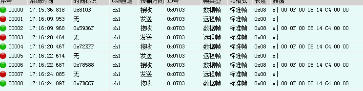

  • 你好 我也正在移植CANOPEN,我想请教下远程帧应该怎么发?
    我试了很多方法,手册上说的是把接收对象的TxRqst置高就会引起远程帧的发送。但实际上这么做以后发出的数据还是“数据帧”,而不是远程帧。
     Setting TxRqst for
    a receive object causes the transmission of a remote frame with the same identifier as the data frame for
    which this receive object is configured.
