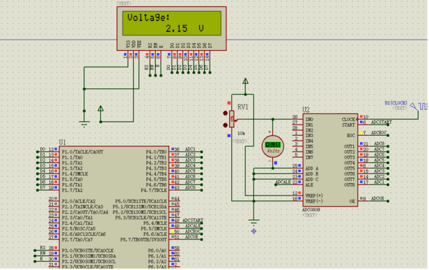

Proteus仿真ADC0808,基于MSP430F249
Other Parts Discussed in Thread: MSP430F249
  • #include <msp430f249.h> #include "KU.h"
    #define ADCST0          P5OUT &= ~BIT4
    #define ADCST1         P5OUT |= BIT4
    #define ADCALE0         P5OUT &= ~BIT5
    #define ADCALE1         P5OUT |= BIT5
    #define ADCEOC0         P5OUT &= ~BIT6
    #define ADCEOC1         P5OUT |= BIT6
    #define ADCOE0          P5OUT &= ~BIT7
    #define ADCOE1          P5OUT |= BIT7
    uchar  ADC1;
    ulong   ADC2;
    uint   MC_wan;
    uint   MC_qian;
    uint   MC_bai;
    uint   MC_shi;
    uint   MC_ge;
    void ADC_START(void)
      ADCALE1;
      ADCST1;
       delay_ms(5);
       ADCALE0;
      ADCST0;
       delay_ms(5);
    char ADC_READ()
      uchar data;
       data=0x00;
       delay_ms(5);
       ADCOE1;
      ADC_START();
       delay_ms(5);
      data=P4IN;
       ADCOE0;
      return data;
    int main( void )
      WDTCTL = WDTPW + WDTHOLD;
        P1SEL = 0x00;
       P1DIR = 0xFF;                  //P1液晶数据
        P3SEL = 0x00;
       P3DIR|= BIT0+BIT1+BIT2;       //P3液晶控制
       LCD_init();
       LCD_clear();
        delay_ms(50);
       P4SEL = 0x00;
       P4DIR = 0x00;
       P5SEL = 0x00;
       P5DIR |= BIT4+BIT5+BIT6;
       while(1)
         ADC1=ADC_READ();
          ADC2=(ADC1*100)/51;
         MC_wan=(ADC2/10000);
         MC_qian=(ADC2-(MC_wan*10000))/1000;
           MC_bai=((ADC2-(MC_wan*10000)-(MC_qian*1000))/100);
         MC_shi=((ADC2-(MC_wan*10000)-(MC_qian*1000)-(MC_bai*100))/10);
    MC_ge=(ADC2-(MC_wan*10000)-(MC_qian*1000)-(MC_bai*100)-(MC_shi*10));
               LCD_clear();
          LCD_write_str(0,0,"Voltage:");
          LCD_write_char(0x07,1,MC_bai+48);
           LCD_write_char(0x08,1,46);
          LCD_write_char(0x09,1,MC_shi+48);
          LCD_write_char(0x0A,1,MC_ge+48);
          LCD_write_char(0x0D,1,86);
          delay_ms(500);
