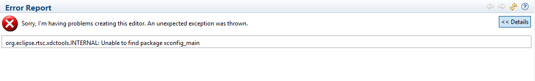

CCS6.1.3创建MSP430的Grace工程师报错
如图,这个问题该如何解决?
  • You can select one of the projects, clean and close all XGCONF sessions you have. Then in Windows Explorer, find the project's top directory. Check if there is a directory .config in the top directory, and also check if there is a directory .config under Debug or Release. Delete all .config directories and try opening the cfg script in XGCONF again.
  • it doesn't work. I install the Grace in CCS App Center. It confuse me that there have no grace examples  in TI Resource Explorer. Maybe, I should remove the Grace and reinstall it again. How to remove it completely?
