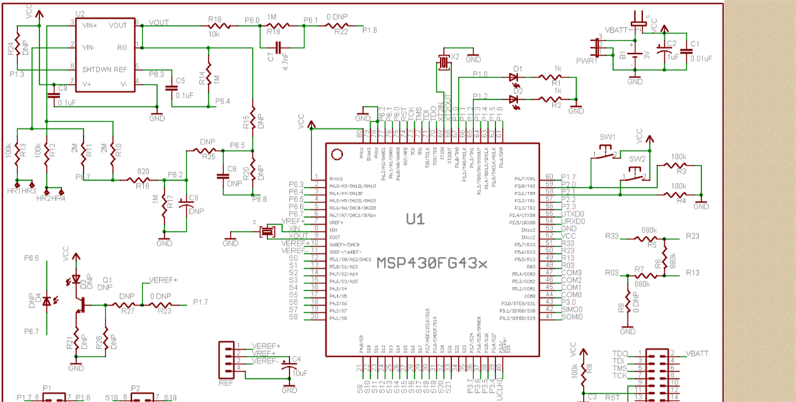

MSP430FG439系列的单片机的OA不工作,无法实现低频信号的放大,这是怎么回事?大神帮帮忙,解释一下,这是为什么???

// MSP430FG439-Heart Rate Monitor Demo
// Description; Uses one Instrumentation Amplifier INA321 and the three
// internal opamps of the MSP430FG439
// LSD ZHANGCHONG
// MAY 2006
// Built with IAR Embedded Workbench Version: 3.20A
#include <msp430xG43x.h>

ADC12CTL0 = ADC12ON + SHT0_4 + REFON + REF2_5V; // ADC12 ON, Reference = 2.5V for DAC0
ADC12CTL1 = SHP + SHS_1 + CONSEQ_2; // Use sampling timer, TA1 trigger
ADC12MCTL0 = INCH_1 + SREF_1; // Vref, channel = 1 = OA0 Out
ADC12IE = BIT0; // Enable interrupt for ADC12 MEM0
ADC12CTL0 |= ENC; // Enable conversions
// Initialize and enable Timer_A
TACTL = TASSEL0 + MC_1 + TACLR; // ACLK, Clear TAR, Up Mode
TACCTL1 = OUTMOD_2; // Set / Reset
TACCR0 = 63; // 512 samples per second
TACCR1 = 15; //
// Initialize and enable DAC12x
DAC12_0CTL = DAC12OPS + DAC12CALON + DAC12IR + DAC12AMP_2 + DAC12ENC;// DAC0 enable
DAC12_1CTL = DAC12CALON + DAC12IR + DAC12AMP_2 + DAC12ENC; // DAC1 enable
DAC12_1DAT = 0x099A; // Offset level = 1.5V for op amp bias
//DAC12_1DAT = 0x0000; // Offset level = 1.5V for op amp bias
// Initialize and enable opamps
OA0CTL0 = OAP_1 + OAPM_1 + OAADC1; // OA0 enable power mode 1, OA0- = P6.0, 0A0+ = P6.2, OA0O = P6.1
OA0CTL1 = OARRIP; // General purpose mode, no Rail-to-Rail inputs
OA1CTL0 = OAP_3 + OAPM_1 + OAADC1; // OA1 enable power mode 1, OA1- = P6.4, OA1+ = DAC1, OA1O = P6.3
OA1CTL1 = OARRIP; // General purpose mode, no Rail-to-Rail inputs
OA2CTL0 = OAP_3 + OAPM_1 + OAADC1; // OA2 enable power mode 1, OA2+ = DAC1, OA2O = P6.5, Select inputs, power mode
OA2CTL1 = OAFC_1 + OARRIP; // Unit gain Mode, no Rail-to-Rail inputs
