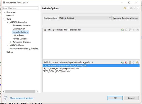

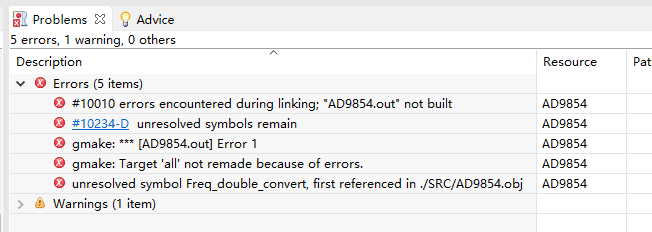

我是在从STM32上移植一个AD9854的驱动代码,使用的是TI的MSP430F5529LP开发板,一直出现这个错误,起初是怀疑工程路径存在空格,与是便把整个Workspace移动到D盘根目录下,并没有解决问题。我在论坛上看到许多其他网友类似的问题,采用了一系列方案,均没有解决,想知道问题出在哪里?该如何解决?
console内容如下
**** Build of configuration Debug for project AD9854 ****
"D:\\Program Files\\TI\\ccsv6\\utils\\bin\\gmake" -k all
'Building target: AD9854.out'
'Invoking: MSP430 Linker'
"D:/Program Files/TI/ccsv6/tools/compiler/ti-cgt-msp430_15.12.1.LTS/bin/cl430" -vmspx --data_model=restricted --use_hw_mpy=F5 --advice:power="all" -g --define=__MSP430F5529__ --diag_warning=225 --display_error_number --diag_wrap=off --silicon_errata=CPU21 --silicon_errata=CPU22 --silicon_errata=CPU23 --silicon_errata=CPU40 --printf_support=minimal -z -m"AD9854.map" --heap_size=160 --stack_size=160 --cinit_hold_wdt=on -i"D:/Program Files/TI/ccsv6/ccs_base/msp430/include" -i"D:/Program Files/TI/ccsv6/ccs_base/msp430/lib/5xx_6xx_FRxx" -i"D:/Program Files/TI/ccsv6/tools/compiler/ti-cgt-msp430_15.12.1.LTS/lib" -i"D:/Program Files/TI/ccsv6/tools/compiler/ti-cgt-msp430_15.12.1.LTS/include" --reread_libs --display_error_number --warn_sections --diag_wrap=off --xml_link_info="AD9854_linkInfo.xml" --use_hw_mpy=F5 --rom_model -o "AD9854.out" "./main.obj" "./SRC/AD9854.obj" "./SRC/Clock.obj" "../lnk_msp430f5529.cmd"  -llibmath.a -llibc.a
<Linking>
 undefined           first referenced
  symbol                 in file
 Freq_double_convert ./SRC/AD9854.obj
remark #10372-D: (ULP 4.1) Detected uninitialized Port C in this project. Recommend initializing all unused ports to eliminate wasted current consumption on unused pins.
error #10234-D: unresolved symbols remain
>> Compilation failure
makefile:145: recipe for target 'AD9854.out' failed
error #10010: errors encountered during linking; "AD9854.out" not built
gmake: *** [AD9854.out] Error 1
gmake: Target 'all' not remade because of errors.
**** Build Finished ****

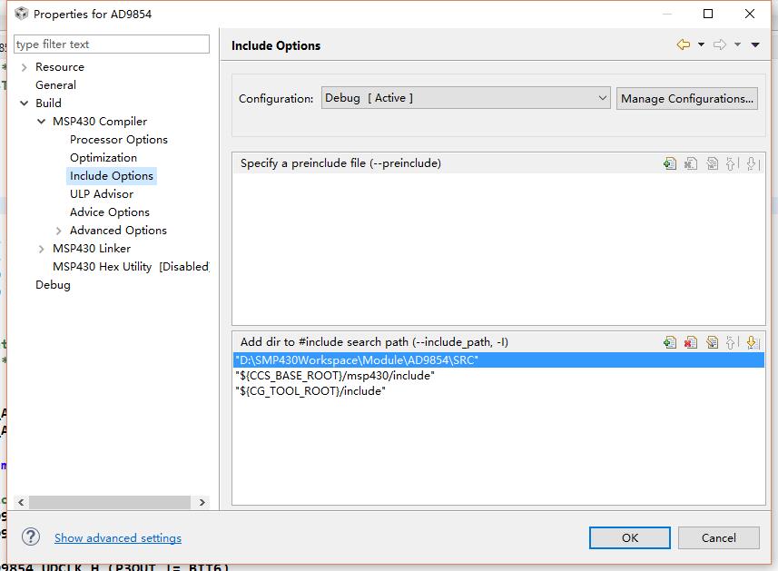

工程配置如下
