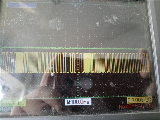

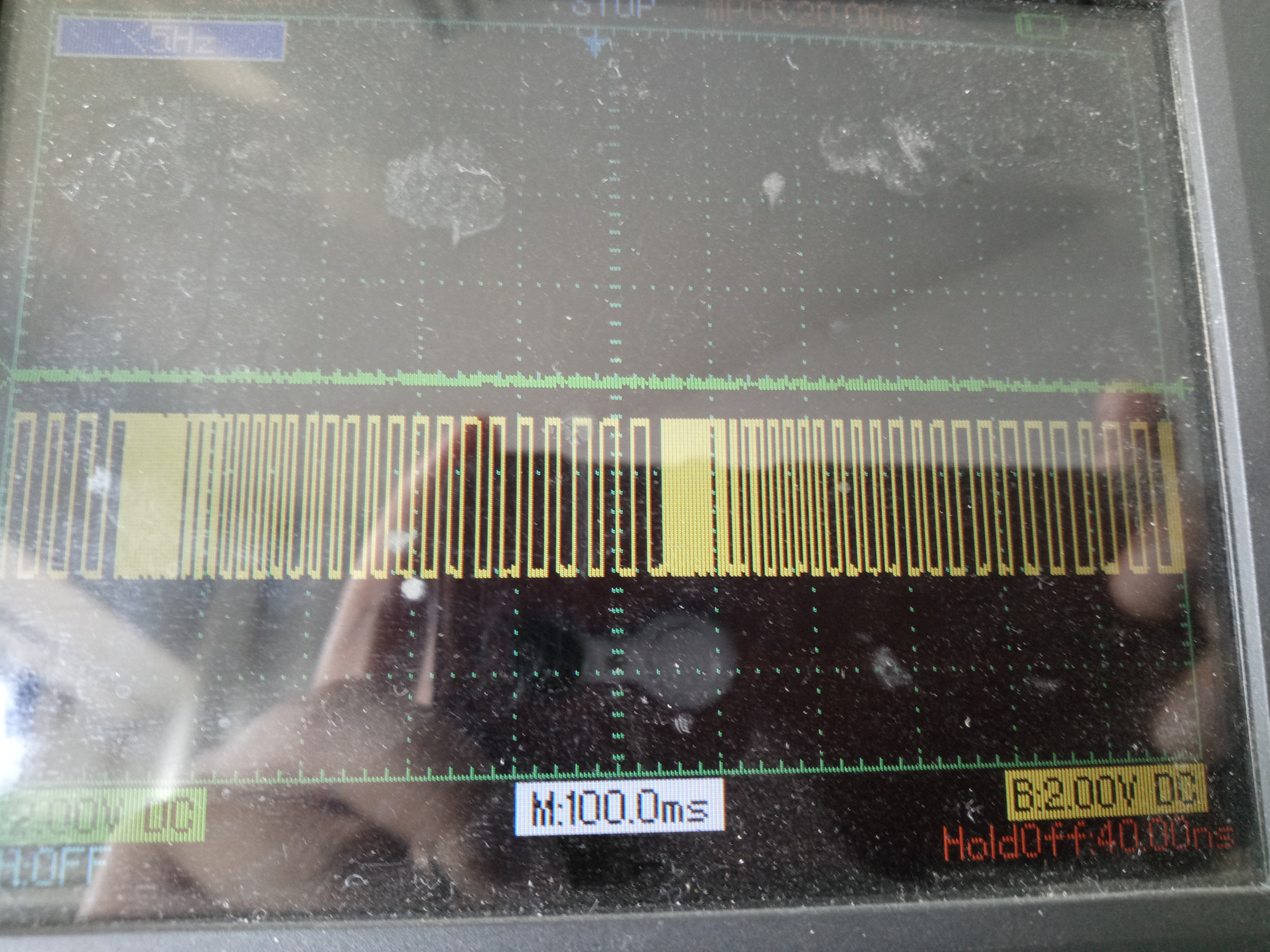

LED翻转测试输出的脉冲宽度不一致时什么原因?
代码:
#include <msp430.h>
int main(void)
WDTCTL = WDTPW + WDTHOLD; // Stop WDT
BCSCTL1 |= XTS;
P3DIR |= 0x20; // P1.0 output
CCTL0 = CCIE; // CCR0 interrupt enabled
CCR0 = 1000;
//TACTL = TASSEL_2 + MC_2; // SMCLK, contmode
TACTL = TASSEL_1 + MC_1;
__bis_SR_register(LPM0_bits + GIE); // Enter LPM0 w/ interrupt
// Timer A0 interrupt service routine
#if defined(__TI_COMPILER_VERSION__) || defined(__IAR_SYSTEMS_ICC__)
#pragma vector=TIMERA0_VECTOR
__interrupt void Timer_A (void)
#elif defined(__GNUC__)
void __attribute__ ((interrupt(TIMERA0_VECTOR))) Timer_A (void)
#else
#error Compiler not supported!
#endif
P3OUT ^= 0x20; // Toggle P1.0
CCR0 += 1000; // Add Offset to CCR0
  • CCR0 += 1000; // Add Offset to CCR0
    增加了周期的数值,宽度肯定会增加,直到CCR0数据溢出
  • john sue 说:
    代码:
    #include <msp430.h>
    int main(void)
    BCSCTL1 |= XTS;
    CCR0 = 1000;
    #else
    #endif
    两种解决方案:
    1. TACTL = TASSEL_2 + MC_2; // SMCLK, contmode
    中断里
    2.TACTL = TASSEL_1 + MC_1;
    中断里
