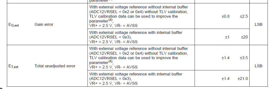

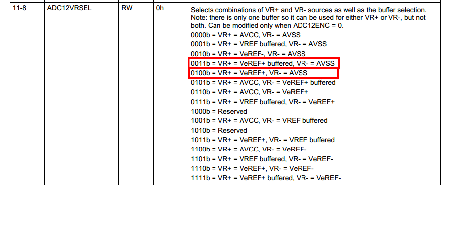

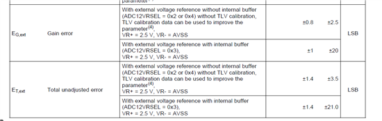

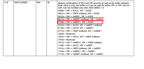

MSP430FR5969 ADC12模块的VeREF+ buffered和VeREF+ 有什么区别
Other Parts Discussed in Thread: MSP430FR5969
如上图所示,MSP430FR5969 ADC12模块的VeREF+ buffered和VeREF+ 有什么区别?谢谢!
