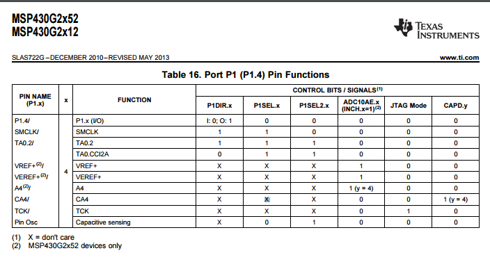

最近在调MSP430G2452的PWM输出驱动蜂鸣器,刚开始使用的是P1.2脚能正常驱动,后来硬件改版,将PWM输出脚换成了P1.4,我按照之前相同的配置方法,发现无法正常驱动蜂鸣器,用示波器也查不到相应的波形,求问P1.4配置成PWM输出,是不是有特殊的配置要求?改怎么配置?谢谢指教!
Other Parts Discussed in Thread: MSP430G2452
#include "msp430g2452.h"
void main( void )
// Stop watchdog timer to prevent time out reset
WDTCTL = WDTPW + WDTHOLD;
BCSCTL1 = CALBC1_1MHZ;
DCOCTL = CALDCO_1MHZ;
P1DIR |= BIT4;
P1SEL |= BIT4;
P1SEL2 |= BIT4; //配置IO口比较输出
TACTL |=TASSEL_2+MC_1+TACLR+TAIE; //选择时钟源smclk 上数模式
TACCTL2 |=CCIE+OUTMOD_7;
TACCR0 = 20000;
TACCR2 = 5000;
_EINT(); //打开总中断
while(1)
#pragma vector=TIMER0_A1_VECTOR
__interrupt void TA0_ISR(void)
