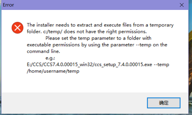

If CCS installation fails with the following error, it means that the system temporary folder does not have the required permissions, OR that the Username, and thereby temporary directory, has non-ASCII characters.
