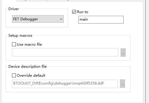

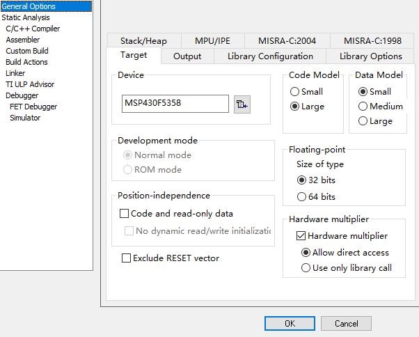

系统是win10 64bit IAR是7.10.1,仿真msp430f5358芯片,仿真器是 MSP-FET430UIF 提示“Fatal error: Could not find device (or device not supported)   Session aborted!”
还有一句警告Warning: The memory names defined in the device description files must be unique. 'RAM' is used more than once. This is not allowed.
具体debug信息为:
Wed Mar 14, 2018 14:15:50: IAR Embedded Workbench 7.10.1 (C:\Program Files (x86)\IAR Systems\Embedded Workbench 8.0\430\bin\430proc.dll)
Wed Mar 14, 2018 14:15:50: Using license: Standalone license - IAR Embedded Workbench for Texas Instruments MSP430
Wed Mar 14, 2018 14:15:51: Firmware version 3.9.2.12
Wed Mar 14, 2018 14:15:51: Interface dll version 3.9.2.15
Wed Mar 14, 2018 14:15:57: Unknown device : (OpenDevice) , Device=MSP430F5358, PwLength=0
Wed Mar 14, 2018 14:15:59: Fatal error: Could not find device (or device not supported)   Session aborted!
Wed Mar 14, 2018 14:15:59: IAR Embedded Workbench 7.10.1 (C:\Program Files (x86)\IAR Systems\Embedded Workbench 8.0\430\bin\430proc.dll)
Wed Mar 14, 2018 14:16:03: Warning: The memory names defined in the device description files must be unique. 'RAM' is used more than once. This is not allowed.
我JTAG供电是外部供电,不是JTAG本身供电。
