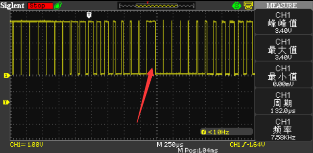

F5529产生SPWM周期性产生一个错值
我用MSP430F5529LP的Timer_A1产生SPWM,会周期性出现一个错误值,求大佬指点一二,波形如下:
代码如下:

void Init_TimerA(void)
	P2DIR |= BIT0;
	P2SEL |= BIT0;
	nCount = 0;
	TA1CCTL1 |= OUTMOD_7;
	TA1CCTL0 = CCIE;                          // CCR0 interrupt enabled
	TA1CCR0 = (256- 1);
	TA1CTL |= TASSEL_2 + ID_1 + MC_1;
	TA1CCR1 = nSinTable[nCount];
	TA1CTL |= TACLR;
int main(void)
  WDTCTL = WDTPW + WDTHOLD;                 // Stop WDT
  Init_CLK();
  Init_TimerA();
//  _EINT();
  __bis_SR_register(LPM0_bits + GIE);       // Enter LPM0, enable interrupts
  __no_operation();                         // For debugger
// Timer0 A0 interrupt service routine
#pragma vector=TIMER1_A0_VECTOR
__interrupt void TIMER1_A0_ISR(void)
		nCount += 1;
		if(nCount >= 32)
			nCount = 0;
