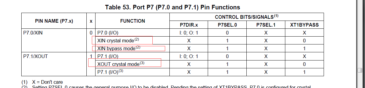

MSP430F5438A UCS模块中XT1 bypass mode疑问
如上图,
 请问,这个XIN CRYSTAL MODE 和XIN PASS MODE分别指什么意思?
可否理解为:
 XIN CRYSTAL MODE是指XT1的源为外部晶振;而XIN PASS MODE,XT1的源为内部时钟,同时不必外接一个晶振?
  • XIN byPASS MODE是旁路模式,就是把dco旁路掉使用外部时钟输入信号
    具体可以看datasheet里的相应内容
     里面的Figure 5-1. UCS Block Diagram比较表达的明白
  • Hi:
    XT1 bypass 应该不是把dco旁路掉吧?UCS Block Diagram我也看了,而且UCSCTL6寄存器中BIT4位XT1BYPASS说明:0b,XT1 sourced internally;1b,XT1 sourced externally from pin。 我不明白的是,BIT4位如果设置为0 ,这个internally 指的是哪个具体的时钟?
  • When XT1BYPASS is set, XT1 circuits are automatically powered down. Input signal is a digital square wave with parametrics defined in
    the Schmitt-trigger Inputs section of this data sheet
    您可以看一下 第5.2.4给出的说明
    On many devices, the XT1 pins are shared with general-purpose I/O ports (refer to the device-specific data sheet for availability). At power up, the default operation is XT1, LF mode of operation. However, for devices that have XT1 shared with general-purpose I/O ports, XT1 will remain disabled until the ports shared with XT1 are configured for XT1 operation. The configuration of the shared I/O is determined by the PxSEL bit associated with XIN and the XT1BYPASS bit. Setting the PxSEL bit causes the XIN and XOUT ports to be configured for XT1 operation. If XT1BYPASS is also set, XT1 is configured for bypass mode of operation, and the oscillator associated with XT1 is powered down. In bypass mode of operation, XIN can accept an external clock input signal and XOUT is configured as a general-purpose I/O. The PxSEL bit associated with XOUT is a don't care. If the PxSEL bit associated with XIN is cleared, both XIN and XOUT ports are configured as general-purpose I/Os, and XT1 is disabled.
