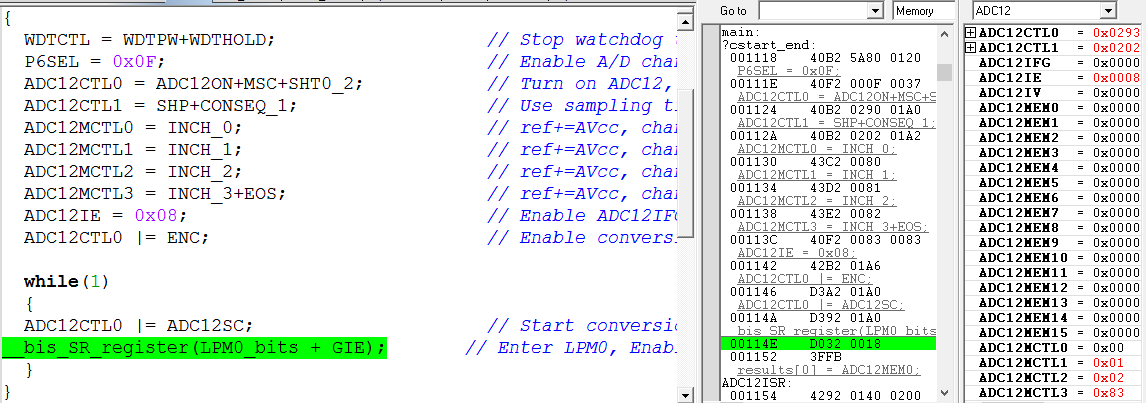

msp430f149AD采集失败问题
硬件出什么问题会使msp430f149在ad采样时失败(无法进入中断),我用的TI给的ad采样的例程,在线调试时应该是无法进入中断,在register栏中MEM0,MEM1,MEM2,MEM3的值都为零,求会的朋友帮忙,谢谢了!!ad转换的值没有写进去如下图
程序如下
#include <msp430.h>
static unsigned int results[4]; // Needs to be global in this example
// Otherwise, the compiler removes it
// because it is not used for anything.
int main(void)
WDTCTL = WDTPW+WDTHOLD; // Stop watchdog timer
P6SEL = 0x0F; // Enable A/D channel inputs
ADC12CTL0 = ADC12ON+MSC+SHT0_2; // Turn on ADC12, set sampling time
ADC12CTL1 = SHP+CONSEQ_1; // Use sampling timer, single sequence
ADC12MCTL0 = INCH_0; // ref+=AVcc, channel = A0
ADC12MCTL1 = INCH_1; // ref+=AVcc, channel = A1
ADC12MCTL2 = INCH_2; // ref+=AVcc, channel = A2
ADC12MCTL3 = INCH_3+EOS; // ref+=AVcc, channel = A3, end seq.
ADC12IE = 0x08; // Enable ADC12IFG.3
ADC12CTL0 |= ENC; // Enable conversions
while(1)
ADC12CTL0 |= ADC12SC; // Start conversion
__bis_SR_register(LPM0_bits + GIE); // Enter LPM0, Enable interrupts
#if defined(__TI_COMPILER_VERSION__) || defined(__IAR_SYSTEMS_ICC__)
#pragma vector=ADC12_VECTOR
__interrupt void ADC12ISR (void)
#elif defined(__GNUC__)
void __attribute__ ((interrupt(ADC12_VECTOR))) ADC12ISR (void)
#else
#error Compiler not supported!
#endif
results[0] = ADC12MEM0; // Move results, IFG is cleared
results[1] = ADC12MEM1; // Move results, IFG is cleared
results[2] = ADC12MEM2; // Move results, IFG is cleared
results[3] = ADC12MEM3; // Move results, IFG is cleared
__bic_SR_register_on_exit(LPM0_bits); // Clear LPM0, SET BREAKPOINT HERE
