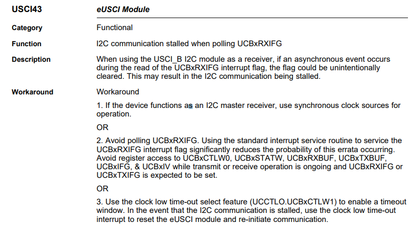

MSP432 IIC 标志位不置位,求大神解答
用的官方给的例程,改了地址和数据,程序就会死在一句标志位检查语句
一直死在while里,这是在driverlib.c文件中
while (!BITBAND_PERI(EUSCI_B_CMSIS(moduleInstance)->rIFG.r, UCTXIFG_OFS));
我的程序,如下,死在了标红的语句里。

while (1)
RXData=0;
/* Making sure the last transaction has been completely sent out */
while (MAP_I2C_masterIsStopSent(EUSCI_B0_BASE));
/* Send out EEPROM Mock Read Cmd (2 databytes) */
MAP_I2C_masterSendMultiByteStart(EUSCI_B0_BASE, TXData[1]); // Start + 1Byte
MAP_I2C_masterSendMultiByteNext(EUSCI_B0_BASE, TXData[0]); // Poll for TXINT,Send 1Byte
/* Now we need to initiate the read */
/* Wait until 2nd Byte has been output to shift register */
while(!(EUSCI_B0->IFG & EUSCI_B_IFG_TXIFG0));
// Send the restart condition, read one byte, send the stop condition right away
EUSCI_B0->CTLW0 &= ~(EUSCI_B_CTLW0_TR);
EUSCI_B0->CTLW0 |= EUSCI_B_CTLW0_TXSTT;
while(MAP_I2C_masterIsStartSent(EUSCI_B0_BASE));
EUSCI_B0->CTLW0 |= EUSCI_B_CTLW0_TXSTP;
//while(!(EUSCI_B0->IFG & EUSCI_B_IFG_RXIFG0));
//RXData = EUSCI_B0->RXBUF;
MAP_PCM_gotoLPM0InterruptSafe();
