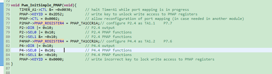

使用PMAP配置P2.4和P4.4为TA1.1和TA1.2功能配置电机,P2.4配置成功,出现了PWM波形,但是P4.4配置失败,想知道是什么原因:

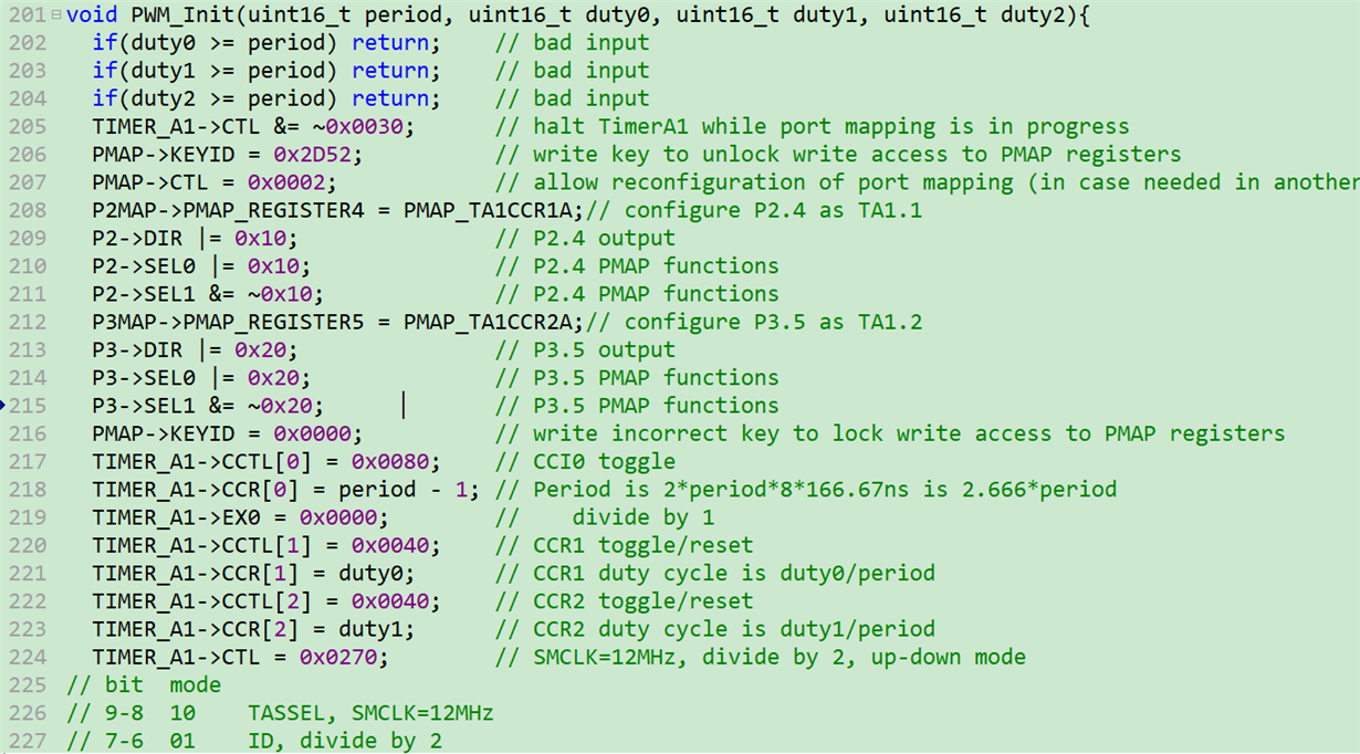

    // functions in PWM.c slightly modified below
    //***************************PWM_Init*******************************
    // PWM outputs on P2.4/PM_TA0.1 (PMAP from TA1.1), P3.5/PM_UCB2CLK (PMAP from TA1.2), and P5.7/TA2.2/VREF-/VeREF-/C1.6
    // Inputs:  period (333.33ns)
    //          duty0 (0<=duty0<period-1)
    //          duty1 (0<=duty1<period-1)
    //          duty2 (0<=duty2<period-1)
    // Outputs: none
    // SMCLK = 48MHz/4 = 12 MHz, 83.33ns
    // Use clock divider of 2 to get timer clock period 166.67ns
    // Counter counts up to TAnCCR0 and back down
    // Let Timerclock period T = 2/12MHz = 166.67nsns
    // P2.4=1 when timer equals TA1CCR1 on way down, P2.4=0 when timer equals TA1CCR1 on way up
    // P3.5=1 when timer equals TA1CCR2 on way down, P3.5=0 when timer equals TA1CCR2 on way up
    // P5.7=1 when timer equals TA2CCR2 on way down, P5.7=0 when timer equals TA2CCR2 on way up
    // Period of P2.4 is period*333.33ns, duty cycle is duty0/period
    // Period of P3.5 is period*333.33ns, duty cycle is duty1/period
    // Period of P5.7 is period*333.33ns, duty cycle is duty2/period
    void PWM_Init(uint16_t period, uint16_t duty0, uint16_t duty1, uint16_t duty2){
      if(duty0 >= period) return;    // bad input
      if(duty1 >= period) return;    // bad input
      if(duty2 >= period) return;    // bad input
      TIMER_A1->CTL &= ~0x0030;      // halt TimerA1 while port mapping is in progress
      PMAP->KEYID = 0x2D52;          // write key to unlock write access to PMAP registers
      PMAP->CTL = 0x0002;            // allow reconfiguration of port mapping (in case needed in another module)
      P2MAP->PMAP_REGISTER4 = PMAP_TA1CCR1A;// configure P2.4 as TA1.1
      P2->DIR |= 0x10;               // P2.4 output
      P2->SEL0 |= 0x10;              // P2.4 PMAP functions
      P2->SEL1 &= ~0x10;             // P2.4 PMAP functions
      P3MAP->PMAP_REGISTER5 = PMAP_TA1CCR2A;// configure P3.5 as TA1.2
      P3->DIR |= 0x20;               // P3.5 output
      P3->SEL0 |= 0x20;              // P3.5 PMAP functions
      P3->SEL1 &= ~0x20;             // P3.5 PMAP functions
      PMAP->KEYID = 0x0000;          // write incorrect key to lock write access to PMAP registers
      TIMER_A1->CCTL[0] = 0x0080;    // CCI0 toggle
      TIMER_A1->CCR[0] = period - 1; // Period is 2*period*8*166.67ns is 2.666*period
      TIMER_A1->EX0 = 0x0000;        //    divide by 1
      TIMER_A1->CCTL[1] = 0x0040;    // CCR1 toggle/reset
      TIMER_A1->CCR[1] = duty0;      // CCR1 duty cycle is duty0/period
      TIMER_A1->CCTL[2] = 0x0040;    // CCR2 toggle/reset
      TIMER_A1->CCR[2] = duty1;      // CCR2 duty cycle is duty1/period
      TIMER_A1->CTL = 0x0270;        // SMCLK=12MHz, divide by 2, up-down mode
    // bit  mode
    // 9-8  10    TASSEL, SMCLK=12MHz
    // 7-6  01    ID, divide by 2
    // 5-4  11    MC, up-down mode
    // 2    0     TACLR, no clear
    // 1    0     TAIE, no interrupt
    // 0          TAIFG
      P5->DIR |= 0x80;               // P5.7 output
      P5->SEL0 |= 0x80;              // P5.7 TimerA2.2 functions
      P5->SEL1 &= ~0x80;             // P5.7 TimerA2.2 functions
      TIMER_A2->CCTL[0] = 0x0080;    // CCI0 toggle
      TIMER_A2->CCR[0] = period - 1; // Period is 2*period*8*166.67ns is 2.666*period
      TIMER_A2->EX0 = 0x0000;        //    divide by 1
      TIMER_A2->CCTL[2] = 0x0040;    // CCR2 toggle/reset
      TIMER_A2->CCR[2] = duty2;      // CCR2 duty cycle is duty2/period
      TIMER_A2->CTL = 0x0270;        // SMCLK=12MHz, divide by 2, up-down mode
    // bit  mode
    // 0          TAIFG

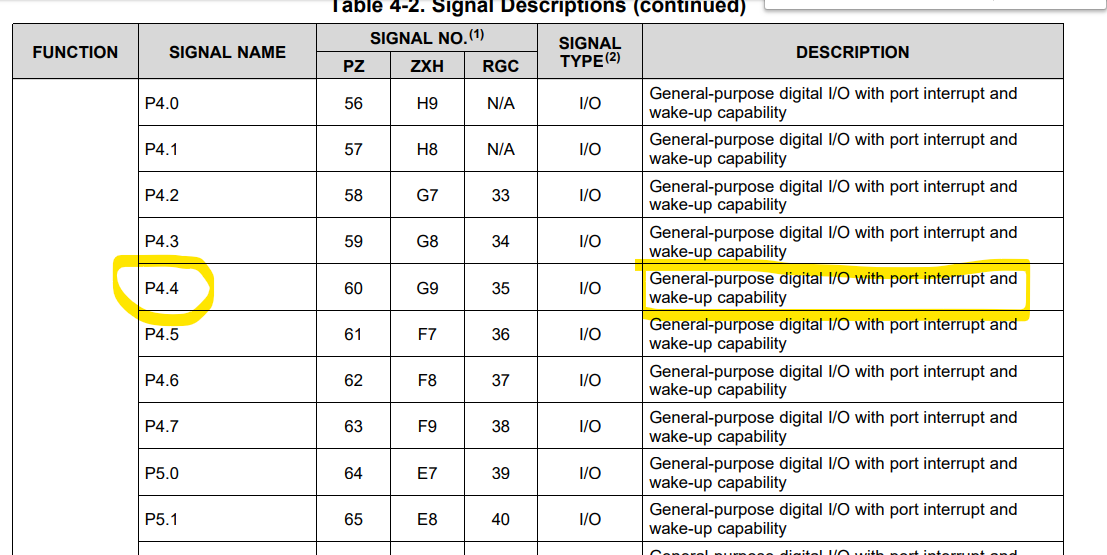

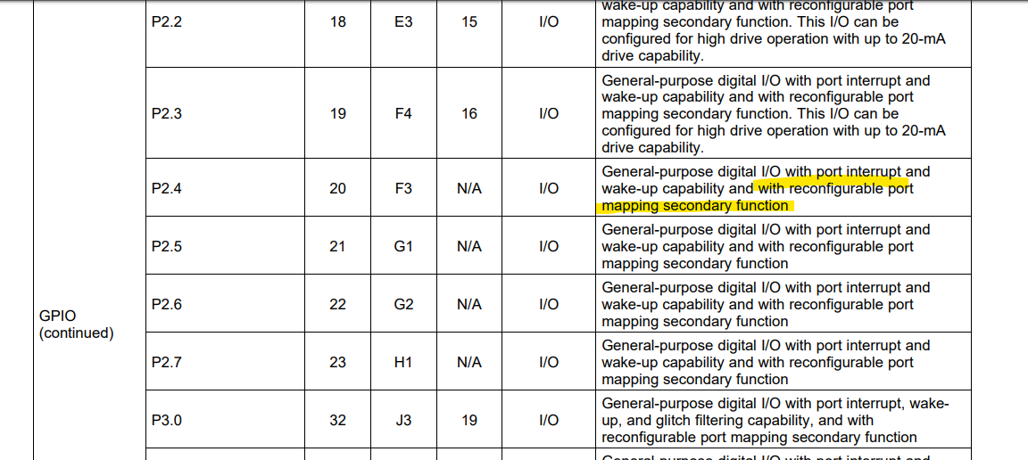

  • 这个您可以看一下数据手册
    http://www.ti.com/cn/lit/ds/symlink/msp432p401r.pdf
    P4.4是不具备reconfigurable port mapping secondary function 这个功能的,也就是说是不可以进行重新配置port map的
    如下图所示
    建议您选用其他可以重新配置port map的引脚
