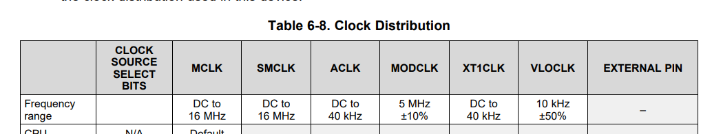

MSP430FR2476 外接晶振最高频率是多少?文档好像只说了能接32KHZ外部晶振

XT1CLK: High-frequency or low-frequency oscillator that can be used with a high-frequency ceramic or crystal oscillator or a low-frequency 32768-Hz crystal. XT1CLK can be used as a clock reference into the FLL. Some devices only support the low-frequency oscillator for XT1CLK.
See the device-specific data sheet for more details
在MSP430FR2476 中,范围为DC-40kHZ,一般使用32768-Hz
