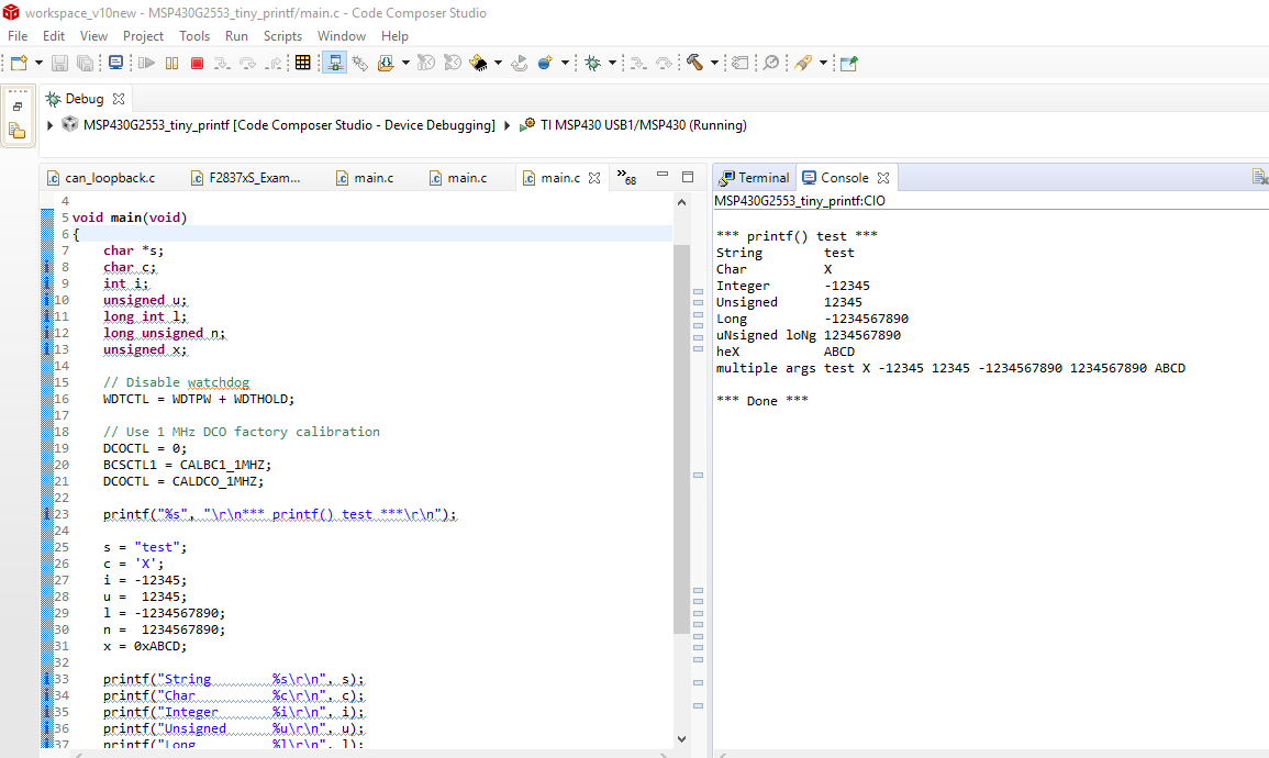

我这里还是不行,报了如下错误:
"../lnk_msp430g2553.cmd", line 100: error #10099-D: program will not fit into available memory. run placement with alignment fails for section ".cio" size 0x120 . Available memory ranges:
RAM size: 0x200 unused: 0x12 max hole: 0x12
"../lnk_msp430g2553.cmd", line 91: error #10099-D: program will not fit into available memory. run placement with alignment fails for section ".data" size 0xfc . Available memory ranges:
"../lnk_msp430g2553.cmd", line 94: error #10099-D: program will not fit into available memory. run placement with alignment fails for section ".stack" size 0x50 . Available memory ranges:
