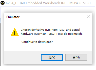

现象如下图。
你好,找到一个类似的问题,你可以参考一下下面的Q&A:
This kind of error appers when the IDE is not already setup with the correct microcontroller.
In our case, we would like to use the MSP430G2553 microcontroller board in order to compile a project.
But there another board in the settings. So the IDE could not compile anything.
To resolve this problem click Project > Options > General Options > Target > Device > Click the tiny icon with an arrow > MSP430Gxxx Family > MSP430G2553 > OK.
