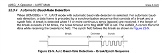

 1.关于break 帧头的检测,目前 Tsynbrk = 13,Tsyndel = 1/5/10,这些都能正确检测到,现在有两种情况检测不到break: Tsynbrk = 13,Tsyndel = 14、 Tsynbrk = 26,Tsyndel = 1 ,请问这是为什么,能解决吗?

  • const tUARTPort g_myLINPort =
    .pbReceiveCallback = &LINreceiveHandler,
    .pbErrorCallback = &LINerrorHandler,
    .peripheralParameters.selectClockSource = EUSCI_A_UART_CLOCKSOURCE_SMCLK,//EUSCI_A_UART_CLOCKSOURCE_UCLK, //EUSCI_A_UART_CLOCKSOURCE_SMCLK,
    .peripheralParameters.clockPrescalar = 6, //26,
    .peripheralParameters.firstModReg = 8, //0,
    .peripheralParameters.secondModReg = 0x11, //0xB6,
    .peripheralParameters.parity = EUSCI_A_UART_NO_PARITY,
    .peripheralParameters.msborLsbFirst = EUSCI_A_UART_LSB_FIRST,
    .peripheralParameters.numberofStopBits = EUSCI_A_UART_ONE_STOP_BIT,
    .peripheralParameters.uartMode = EUSCI_A_UART_AUTOMATIC_BAUDRATE_DETECTION_MODE,//EUSCI_A_UART_AUTOMATIC_BAUDRATE_DETECTION_MODE
    .peripheralParameters.overSampling = EUSCI_A_UART_OVERSAMPLING_BAUDRATE_GENERATION //EUSCI_A_UART_LOW_FREQUENCY_BAUDRATE_GENERATION//EUSCI_A_UART_OVERSAMPLING_BAUDRATE_GENERATION
    void LIN_GPIO_Init(void)
    P1OUT = (0);
    P1DIR = (0);//(GPIO_PIN0 | GPIO_PIN6 | GPIO_PIN7);
    P1SEL0 = (GPIO_PIN4 | GPIO_PIN5); //(GPIO_PIN2 | GPIO_PIN3 | GPIO_PIN4 | GPIO_PIN5);
    P1SEL1 = (0);
    LIN_EN_POUT |= LIN_EN_PIN;
    LIN_EN_PDIR |= LIN_EN_PIN;
    LIN_EN_ON;
    void LIN_Init(void)
    LIN_GPIO_Init();
    UART_openPort(&g_myLINPort);
    void UART_openPort(const tUARTPort *pPort)
    UART_closePort();
    g_pUARTPort = pPort;
    UCA0CTLW0 |= UCSWRST; //reset UART0
    MAP_EUSCI_A_UART_init(
    UART__EUSCI_A_PERIPHERAL,
    (EUSCI_A_UART_initParam*)&(g_pUARTPort->peripheralParameters)
    UCA0CTLW0 |=UCBRKIE; //打开break 中断
    UCA0CTLW0 &= ~UCDORM;//Not dormant. All received characters will set UCAxRXIFG
    MAP_EUSCI_A_UART_enable(UART__EUSCI_A_PERIPHERAL);
    MAP_EUSCI_A_UART_clearInterrupt(
    EUSCI_A_UART_RECEIVE_INTERRUPT_FLAG
    MAP_EUSCI_A_UART_enableInterrupt(
    EUSCI_A_UART_BREAKCHAR_INTERRUPT
    g_UARTStatus = eUARTIsIdle;
