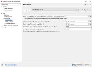

您好,请问我定义数组时报错 program will not fit into available memory, or the section contains a call site that requires a trampoline that can't be generated for this section. run placement with alignment fails for section ".data" size 0x61a4. Available memory ranges:
有什么办法可以解决吗?
你可以先在CCS上看一下内存使用情况,在view - stack usage中可以查看。如果确实内存已满,可以在cmd文件中修改.stack和.heap段的空间大小,同时在CCS的如下位置修改:
