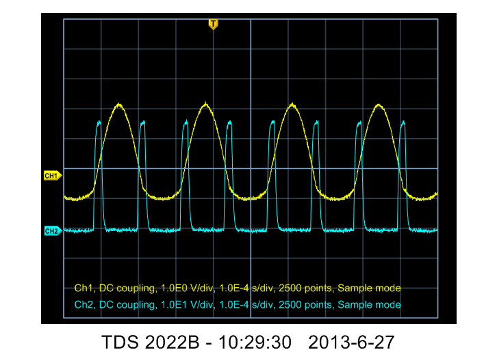

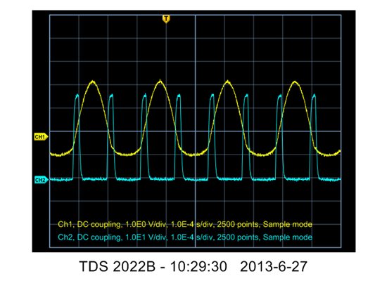

dear  all:
       我写了一个ca的小程序,可是输出波形有问题。为何比较器的输出(蓝色)周期只有原正弦波(黄色)的一半呢。而且高低电平也不对。求解答
#include <msp430g2452.h>
void clk_init(void)
//wdt
WDTCTL = WDTPW +WDTHOLD;//SHUTDOWN WDT
//basic clock system
DCOCTL = CALDCO_8MHZ;// calibration DCO ,8MHZ,(10FC)
BCSCTL1 = CALBC1_8MHZ;// calibration bcs, 8MHZ,(10FD)
//DISABLE INT
_DINT();
void port_init(void)
//p1.0->CA0 no need to setup
P1DIR |= BIT3;                            //P1.3 ->CAOUT
P1SEL |= BIT3;                           //DATASHEET 2X52
P1SEL2 |= BIT3;
void ca_init(void)
CACTL1 = CAEX +CAREF_3+ CAON ;                        //CAEX, CARSEL ->Vcaref(-terminal) ; CAREF_3->~0.55V
CACTL2 = P2CA1 + CAF;                                              //ca1 ->(+terminal) when CAEX =1;

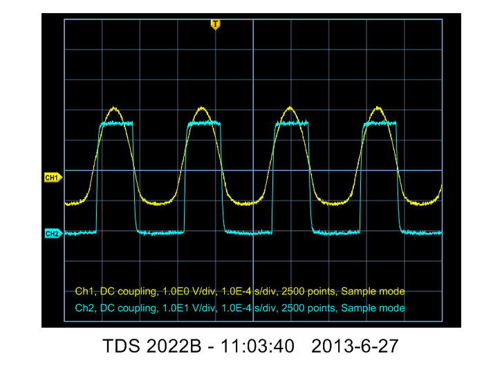

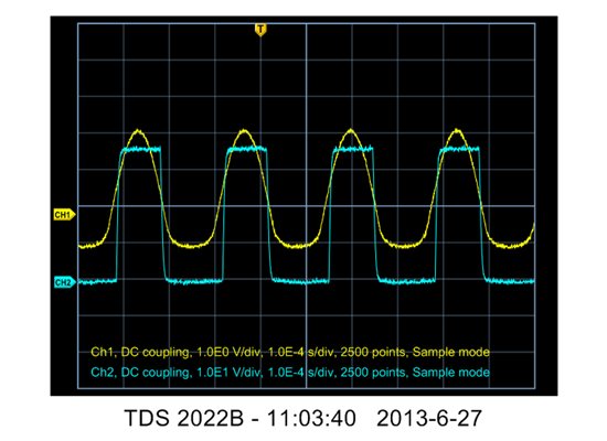

    当我更改CA的设置时,程序和波形如下。波形的周期应该是对的,可是高低电平应该翻了啊。求解答。
    void clk_init(void)
    //wdt
    //DISABLE INT
    _DINT();
    P1SEL2 |= BIT3;
    void ca_init(void)
    CACTL1 = CAEX + CARSEL +CAREF_3+ CAON ;                      //CAEX, CARSEL ->Vcaref(+terminal) ; CAREF_3->~0.55V
    CACTL2 = P2CA0 + CAF;                                                              //CA0->(-terminal) when CAEX =1;CAF ->FILTER
    int main(void)
    clk_init();
    port_init();
    ca_init();
    while(1)
  • 楼主,你好:
    CAEX Bit 7 Comparator_A+ exchange. This bit exchanges the comparator inputs and inverts the comparator output.
    所以拿掉这个位的设置,你再看看。
    谢谢。
