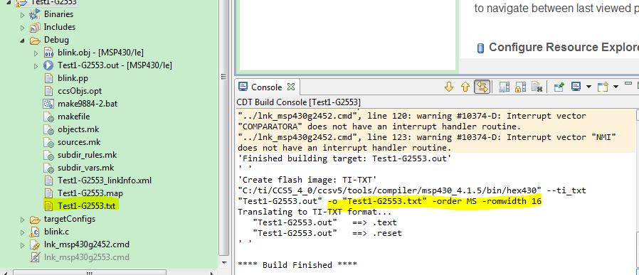

通过在“应用预先定义的步骤”("Apply Predefined Step") 下 拉菜单中选择诸如TI-TXT 和INTEL-HEX 等预先设定的格式,经配置,一个建立之后的步骤能够在每次建 立之后自动生成文件(Project → Properties → Build → Build Steps Tab → Post-Build Step → Apply Predefined Step)。生成的文件存储在<Workspace>\<Project>\Debug\directory 内。我在WORKSPACE里找不到,而在项目原先导入文件夹(例如Home Automation App CCS\CC3000 Automation App\Debug)也没有找到.txt文件的产生。

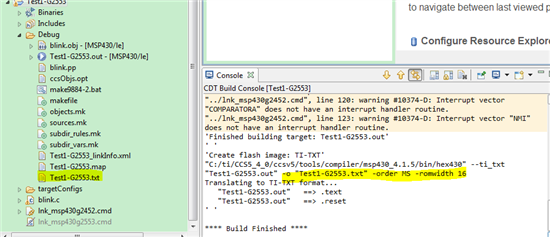

    你先试着Rebuild一下工程,看看工程debug下有没有生成.txt,如果没有,看看最后Console里有没有下列类似提示,如果有,看看有没有相关提示为什么没有生成。
    希望对你有帮助!
  • D:/TI/ccsv5/utils/bin/gmake --no-print-directory post-build 'Create flash image: TI-TXT' "
    D:/TI/ccsv5/tools/compiler/msp430_4.1.2/bin/hex430" --ti_txt "CC3000 Automation App.out" -o "CC3000 Automation App.txt" -order MS -romwidth 16 Translating to TI-TXT format...
    "CC3000 Automation App.out"   ==> .cinit
    "CC3000 Automation App.out"   ==> .const
    "CC3000 Automation App.out"   ==> .text
    "CC3000 Automation App.out"   ==> RTC
    "CC3000 Automation App.out"   ==> PORT4
    "CC3000 Automation App.out"   ==> PORT3
    "CC3000 Automation App.out"   ==> TIMER2_B1
    "CC3000 Automation App.out"   ==> TIMER2_B0
    "CC3000 Automation App.out"   ==> PORT2
    "CC3000 Automation App.out"   ==> TIMER1_B1
    "CC3000 Automation App.out"   ==> TIMER1_B0
    "CC3000 Automation App.out"   ==> PORT1
    "CC3000 Automation App.out"   ==> TIMER1_A1
    "CC3000 Automation App.out"   ==> TIMER1_A0
    "CC3000 Automation App.out"   ==> DMA
    "CC3000 Automation App.out"   ==> USCI_A1
    "CC3000 Automation App.out"   ==> TIMER0_A0
    "CC3000 Automation App.out"   ==> ADC10
    "CC3000 Automation App.out"   ==> USCI_B0
    "CC3000 Automation App.out"   ==> USCI_A0
    "CC3000 Automation App.out"   ==> WDT
    "CC3000 Automation App.out"   ==> TIMER0_B1
    "CC3000 Automation App.out"   ==> TIMER0_B0
    "CC3000 Automation App.out"   ==> COMP_D
    "CC3000 Automation App.out"   ==> UNMI
    "CC3000 Automation App.out"   ==> SYSNMI
    "CC3000 Automation App.out"   ==> .reset ' '
