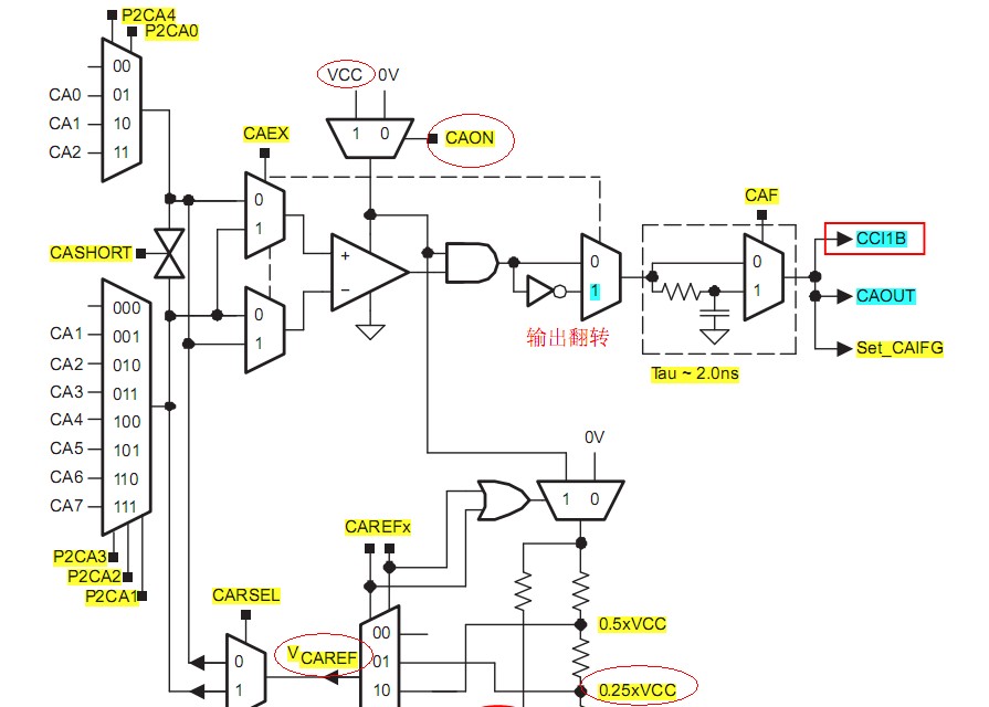

msp430g2553比较器A+模块有几个问题一直困惑着我!求解答
Other Parts Discussed in Thread: MSP430G2553
比较通道设置方面,总是感觉越弄越糊涂。下面是用户指南里面写的。
P2CA3  (1) Bits 5-3 Input select. These bits select the - terminal input when CAEX = 0 and the + terminal input when CAEX = 1.
P2CA2   000 No connection
P2CA1
                001 CA1
                010   CA2
                 011 CA3
                100 CA4
101 CA5
110 CA6
111 CA7
P2CA0 Bit 2 Input select. This bit, together with P2CA4, selects the + terminal input when CAEX = 0 and the - terminal
00 No connection
01 CA0
10 CA1
11 CA2我通过这个的理解是比较通道的选择与CAEX有关,就是CAEX决定是同相还是反相端。可是CCS头文件里面是这样定义的:
#define P2CA0 (0x04) /* Comp. A +Terminal Multiplexer */
#define P2CA1 (0x08) /* Comp. A -Terminal Multiplexer */
#define P2CA2 (0x10) /* Comp. A -Terminal Multiplexer */
#define P2CA3 (0x20) /* Comp. A -Terminal Multiplexer */
#define P2CA4 (0x40) /* Comp. A +Terminal Multiplexer */在通道选择同相还是反相端上我始终没搞懂。下面我给个例子:CACTL1=CAON+CAIE+CAREF_2+CAEX+CARSEL;
CACTL2&=~P2CA2;CACTL2=P2CA3+P2CA1+CAF;按用户指南里面的定义应该是参考电压接正端,CA5选择同相端。这样的话不是相当于都在比较器的正端接着吗?应该不是多输入端那种吧?
