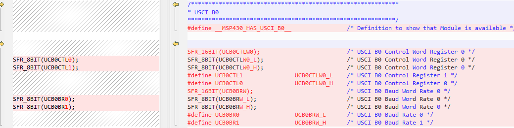

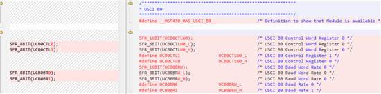

ccs4.1.2编译问题
Other Parts Discussed in Thread: MSP430F5438, CC1100
"./CentralCommon.obj" "./CC1100.obj" "./ADC.obj" "../lnk_msp430f5438.cmd" <Linking>
 undefined   first referenced
 symbol         in file
 UCA0BRW_H   ./uca0uart.obj
  UCA0BRW_L   ./uca0uart.obj
  UCA0CTLW0_H ./uca0uart.obj
  UCA0CTLW0_L ./uca0uart.obj
   UCA0ICTL_L  ./uca0uart.obj
  UCA1BRW_H   ./uca1uart.obj
 UCA1BRW_L   ./uca1uart.obj
 UCA1CTLW0_H ./uca1uart.obj
 UCA1CTLW0_L ./uca1uart.obj
   UCA1ICTL_H  ./uca1uart.obj
   UCA1ICTL_L  ./uca1uart.obj
error: unresolved symbols remain
我是将cce3.1导入到ccs4.1.2 编译出现的问题
