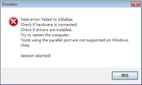

MSP-FET430UIF仿真出现错误
在用MSP-FET430UIF进行仿真时总提示一个错误:
  • shuangxi wu,
    这说明硬件连接有问题,有可能是JTAG电路有问题,供电有问题,也有可能是芯片损坏。
    请先检查供电,并参考下列连接检查硬件电路。
    http://processors.wiki.ti.com/index.php/JTAG_(MSP430)
    BR,
    Lina
  • 经过验证是IAR的版本与仿真器不兼容,更换了高的版本的IAR,问题得到解决,但是换到高的版本以后 执行 make 又出现了新的问题
    Error[e183]: Static overlay map generation (-xo) is not supported for the MSP430 processor.
  • shuangxi wu,
    解决方法如下:
    来源:http://www.anaren.com/air-wiki-zigbee/Known_bugs_and_workarounds
    Project may not build with latest IAR EW430 v5.52.1(minor)
    The AIR-ZNP projects for the MSP-430G2553 may not build properly in the latest version of IAR -- v5.52.1. This may in fact be an IAR bug. But it is easy to work around.
    You will see:
    Linking
    Error while running Linker
    Workaround
    In IAR EW430, go to Project -> Options -> Category: Linker -> Tab: List. Uncheck the Static Overlay Map checkbox.
    BR,
    Lina
