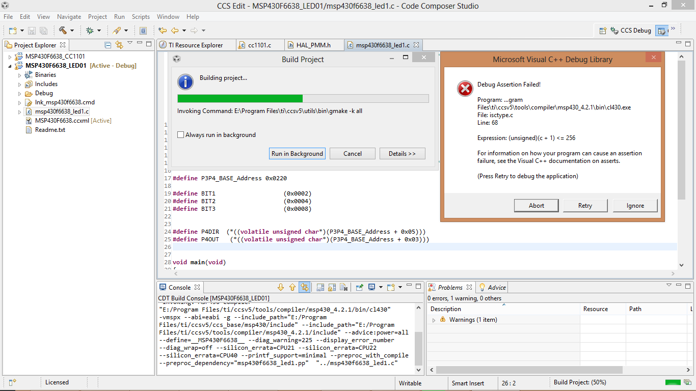

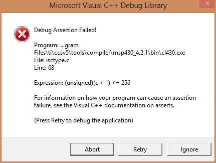

我在用CCS编译一个自带的MSP430例程,编译下载均反复出现Debug assertion failed对话框
系统:win8 64位
CCS:5.5.0.00077
以确认没有中文路径问题,与选用芯片也无关,自建工程同样出错,急求解决,谢谢!
/*** *isctype.c - support is* ctype functions/macros for two-byte multibyte chars * * Copyright (c) Microsoft Corporation. All rights reserved. * *Purpose: * Defines _isctype.c - support is* ctype functions/macros for * two-byte multibyte chars. * *******************************************************************************/ #include <stdio.h> #include <cruntime.h> #include <ctype.h> #include <locale.h> #include <awint.h> #include <dbgint.h> #include <mtdll.h> #include <setlocal.h> /* * Use GetCharType() API so check that character type masks agree between * ctype.h and winnls.h */ #if _UPPER != C1_UPPER || \ _LOWER != C1_LOWER || \ _DIGIT != C1_DIGIT || \ _SPACE != C1_SPACE || \ _PUNCT != C1_PUNCT || \ _CONTROL != C1_CNTRL #error Character type masks do not agree in ctype and winnls #endif /* _UPPER != C1_UPPER || \ */ /*** * __chvalidator * * Purpose: * This function is called by character testing functions in debug * versions. This function test for validation of c as character. * For improvement in performance, it is not used in non-debug * version. It is available in the static single-thread non-debug * build, though, just in case C code that includes ctype.h is compiled * /D_DEBUG /ML. * *******************************************************************************/ #if defined (_DEBUG) extern "C" int __cdecl _chvalidator( int c, int mask ) { _ASSERTE(c >= -1 && c <= 255); return _chvalidator_l(NULL, c, mask); } extern "C" int __cdecl _chvalidator_l( _locale_t plocinfo, int c, int mask ) { _LocaleUpdate _loc_update(plocinfo); _ASSERTE(c >= -1 && c <= 255); if (c >= -1 && c <= 255) { return (_loc_update.GetLocaleT()->locinfo->pctype[c] & mask); } else { return (_loc_update.GetLocaleT()->locinfo->pctype[-1] & mask); } } #endif /* defined (_DEBUG) */ /*** *_isctype - support is* ctype functions/macros for two-byte multibyte chars * *Purpose: * This function is called by the is* ctype functions/macros * (e.g. isalpha()) when their argument is a two-byte multibyte char. * Returns true or false depending on whether the argument satisfies * the character class property encoded by the mask. * *Entry: * int c - the multibyte character whose type is to be tested * unsigned int mask - the mask used by the is* functions/macros * corresponding to each character class property * * The leadbyte and the trailbyte should be packed into the int c as: * * H.......|.......|.......|.......L * 0 0 leadbyte trailbyte * *Exit: * Returns non-zero if c is of the character class. * Returns 0 if c is not of the character class. * *Exceptions: * Returns 0 on any error. * *******************************************************************************/ extern "C" int __cdecl _isctype_l ( int c, int mask, _locale_t plocinfo ) { int size; unsigned short chartype; char buffer[3]; _LocaleUpdate _loc_update(plocinfo); /* c valid between -1 and 255 */ if ( c >= -1 && c <= 255 ) return _loc_update.GetLocaleT()->locinfo->pctype[c] & mask; if ( _isleadbyte_l(c >> 8 & 0xff, _loc_update.GetLocaleT()) ) { buffer[0] = (c >> 8 & 0xff); /* put lead-byte at start of str */ buffer[1] = (char)c; buffer[2] = 0; size = 2; } else { buffer[0] = (char)c; buffer[1] = 0; size = 1; } if ( 0 == __crtGetStringTypeA( _loc_update.GetLocaleT(), CT_CTYPE1, buffer, size, &chartype, _loc_update.GetLocaleT()->locinfo->lc_codepage, TRUE) ) { return 0; } return (int)(chartype & mask); } extern "C" int __cdecl _isctype ( int c, int mask ) { if (__locale_changed == 0) { return __initiallocinfo.pctype[c] & mask; } else { return _isctype_l(c, mask, NULL); } }

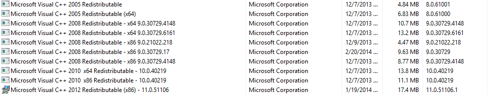

microsoft visual C++ 2008/2012 redistributable
microsoft .Net Framework 4
上面两个有没有提示安装在CCSv5安装的时候。
查了一些资料,说是char变量设置成有符号signed了,断言报错,不知道在哪设置的
野指针或内存泄露
你好,
我后面发现的原因是因为我电脑的双显卡原因,好像是关闭双显卡。你可以参考一下
