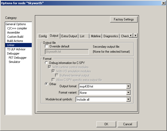

我在使用IAR直接下载(Project -> Download -> Download active application)程序到MSP430G2 Launchpad开发板时,下载没成功,不知道是那里出现了问题,请高手们指点,非常感谢!
debug显示如下:
IAR使用的版本是6.10.1
Tue Jun 10, 2014 08:59:41: Using license: Evaluation license - IAR Embedded Workbench for Texas Instruments MSP430, Evaluation Version 6.10
Tue Jun 10, 2014 08:59:42: Firmware version 30066536
Tue Jun 10, 2014 08:59:42: Interface dll version 2.4.9.1
Tue Jun 10, 2014 08:59:42: Invalid parameter(s) : (Configure) , mode=0xe, value=0x0
Tue Jun 10, 2014 08:59:42: Device : F20x2_G2x2x_G2x3x
Tue Jun 10, 2014 08:59:42: External voltage : 0.0 V
Tue Jun 10, 2014 08:59:42: VCC voltage : 3.5 V
Tue Jun 10, 2014 08:59:42: Failed to load debugee: F:\PROJECT\Program\p1\Debug\Exe\test1.d43
Tue Jun 10, 2014 08:59:42: No trigger sequencer implemented on connected device : (SetEEMSequencer)
Tue Jun 10, 2014 08:59:43: No trigger sequencer implemented on connected device : (SetEEMSequencer)
  • 你好,
    注意看一下你option里面MSP430 device的选择是否正确。
    另外,你是不是修改了output文件的信息导致?
    另外,关闭IAR重新编译下载试试
