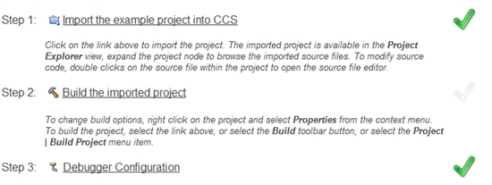

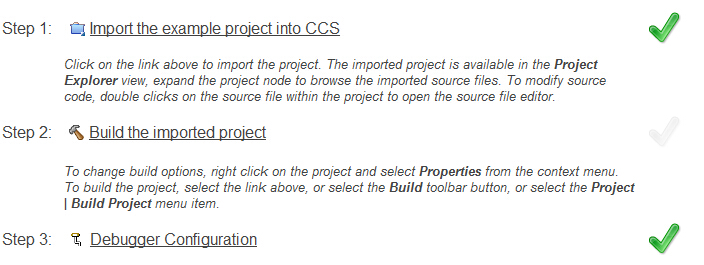

我使用的是TI官网下的CCS V6,按照实验指导书,在尝试Step3:Build  User Experience Project(Code Limited)时报错;不知如何解决

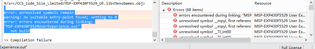

  • 安装路径不是默认的,我改到了D盘。编译时出现以下问题,怎么解决

    'd:/program' 不是内部或外部命令,也不是可运行的程序
    或批处理文件。
    >> ERROR: mklib: could not unpack rtssrc.zip

    error: unresolved symbols remain
    warning: no suitable entry-point found; setting to 0
    >> Compilation failure
    error: errors encountered during linking; "MSP-EXP430F5529UserExperience.out"
    not built
    gmake: *** [MSP-EXP430F5529UserExperience.out] Error 1
    gmake: Target `all' not remade because of errors.
