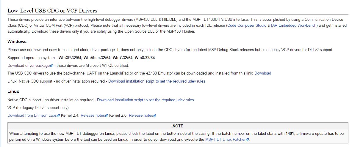

当launchpad插到电脑上可正常识别为U盘,button1 button2 功能正常,但是就是MSP Application Uart和MSP Debug interface 的驱动安装不了,结果如附件所示,请问这是怎么回事?
Download driver package - these drivers are Microsoft WHQL certified.
The USB CDC drivers to use the back-channel UART on the LaunchPad or on the eZ430 Emulator can be downloaded and installed from this link: Download
第1个驱动安装成功,第二个驱动CDC这个还是没成功
