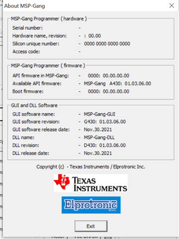

  • That error could be due to hardware connection issues. Can you try programming the board once with the MSP-GANG GUI and see what the result is?
    While using the GUI, can you also check the gang software revision and firmware versions?
  • Thank you for your reply!
    1.Use MSP-GANG GUI,use Interactive mode, it can programming the board.
    2.gang revision is below:
  • I have already followed these information up.
  • Thank you! Yale!
