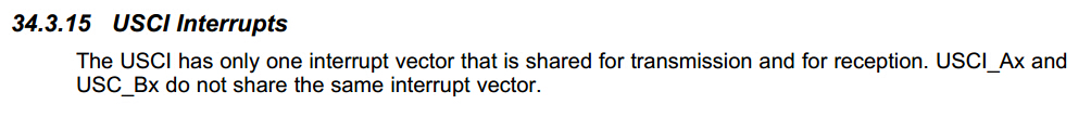

设计中使用了MSP430F5529的USCI功能,其中
USCI_A1    -----------    UART
USCI_B1    -----------    IIC
调试的时候发现这个两个不能同时使用,因此查看手册有以下说明:
这是不是说明该芯片的USCI_A1和USCI_B1不能同时中断使用!!如果可以,应如何设置,谢谢!!
  • 可以同时使用的.
    34.3.15这两句话,第一句是针对只有USCI模块的msp430说的,第二句是对同时有USCI_Ax和USCI_Bx模块的单片机说的
  • MSP430x5xx and MSP430x6xx Family User's Guide
    Literature Number: SLAU208N June 2008–Revised May 2014 (ditto)
    34.3.15 USCI Interrupts
    The USCI has only one interrupt vector that is shared for transmission and for reception. USCI_Ax and USC_Bx do not share the same interrupt vector.
    35.3.8 SPI Interrupts
    (Ditto)
    36.3.7 USCI Interrupts in I2C Mode
    (Ditto)
    I think “USC_Bx” is a typo and the repeating paragraph meant:
    “Each USCI_Ax and each USCI_Bx has only one interrupt vector that is shared for transmission and for reception.”
  • 你理解错了。这段话要分开看,有两层意思:
    1. 每个USCI只有一个中断向量,发送和接收共用一个中断向量。
    2. 5529有两个USCI:USCI_Ax和USC_Bx,它们分别使用不同的中断向量
    其实你去看5529的中断向量表就知道了,USCI_A1和USC_B1分别有中断向量USCI_B1和USCI_A1与之对应!
    所以USCI_A1和USCI_B1中断当然可以同时使用了!
