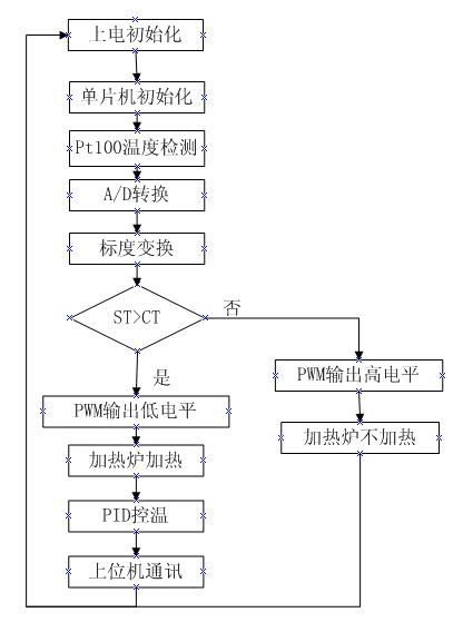

msp430f149温度pid控制
程序框架:
本设计使用高速晶体振荡器,程序如下:
BCSCTL1 &= ~XT2OFF;//打开XT2高频晶体振荡
do
   IFG1 &= ~OFIFG;//清除晶振失败标志
   for (i = 0xFF; i > 0; i--);//等待8MHz晶体起振
   while ((IFG1 & OFIFG));//晶振失效标志仍然存在?
   BCSCTL2 |= SELM_2 + SELS;//MCLK和SMCLK选择高频晶振
PID算法程序:
void PIDCalc(void)
float Rate;//误差变化率
Current_Error =   Set_Temp  - Pre_Temp ;// 当前误差计算
Sum_Error    +=   Current_Error;// 误差积分
Prev_Error    =   Last_Error;// 存储误差更新
Last_Error    =   Current_Error;// 存储误差更新
Rate          =   ( Current_Error - Last_Error )*1000/ Ctrl_Period;
// 当前误差微分
if(Rate>5)//对误差变化率进行限制,锅炉温度不可能变化太大
Rate=5;
if(Rate<-5)
Rate=-5;
    P_OUT = P * Gain * Current_Error  ; /*比例项*/
I_OUT = I * Gain * Sum_Error  ;/*积分项*/
//积分限幅处理
if( I_OUT>PID_I_MAX )  I_OUT = PID_I_MAX;
if( I_OUT<PID_I_MIN )  I_OUT = PID_I_MIN;
if( ( Current_Error <= 2.5 ) && ( Prev_Error <=2.8))
I_OUT=I_OUT * 0.5;
if( (Current_Error <= 0.45 ) && ( Last_Error <=55))
I_OUT=I_OUT * 0.08;
//因为锅炉只能加温不能降温所以一旦超过设定值令积分值为零
if( ( Current_Error <= 0 ) && ( Last_Error <=0 ))
  I_OUT=0;
  //微分延迟输出处理
  D_OUT= ( D_OUT * Sdde_Para + D * Rate * (1-Sdde_Para) )*Gain  ;
  PID_OUT =  P_OUT  +  I_OUT  +  D_OUT ;
  if ( PID_OUT >= PWM_DATA_MAX )  PID_OUT = PWM_DATA_MAX;
  if ( PID_OUT <= PWM_DATA_MIN )  PID_OUT = PWM_DATA_MIN;
  if( Set_Temp - Pre_Temp >=10)
  PID_OUT=16383;
void main()
Device_Init( );
while(1)
LED8_Rollback;//系统运行指示灯
Parameter_Show( );
