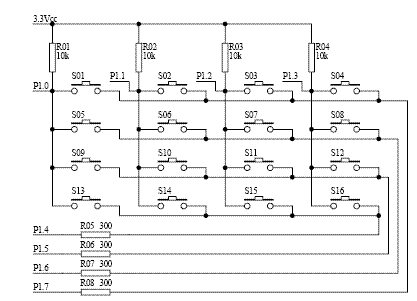

int KeyProcess(void)
int nP10,nP11,nP12,nP13;
int nRes = 0;
//P1.4输出低电平
P1OUT &= ~(BIT4);
nP10 = P1IN & BIT0;
if (nP10 == 0) nRes = 13;
nP11 = P1IN & BIT1;
if (nP11 == 0) nRes = 14;
nP12 = P1IN & BIT2;
if (nP12 == 0) nRes = 15;
nP13 = P1IN & BIT3;
if (nP13 == 0) nRes = 16;
