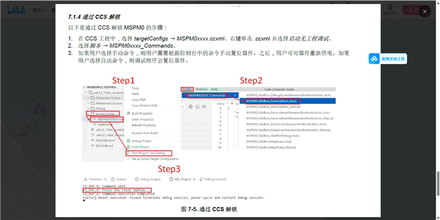

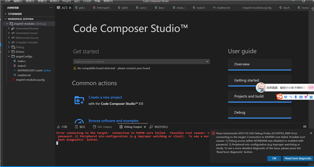

Texas Instruments XDS110 USB Debug Probe_0/CORTEX_M0P Error connecting to the target: Connection to MSPM0 core failed. Possible root causes: 1) Debug access within NONMAIN was disabled or enabled with password. 2) Peripheral mis-configuration (e.g improper watchdog or clock). To see a more detailed diagnostic of the issue, please press the 'Read boot diagnostic' button.,我使用XDS110烧录时会出现这个问题,是什么原因 我用下面方法解锁芯片也不行 他会出现下列错误CS_DAP_0: GEL: Error while executing GEL_DAPInit_externalReset(): Timer id 1 is already configured to call "GEL_DAPInit_resetDeassert()" and must first be canceled
at GEL_SetTimer('GEL'::gDAPBoardResetLen, 1, "GEL_DAPInit_resetDeassert()") [mspm0_cs_dap_init.gel:183]
at GEL_DAPInit_externalReset()问题
