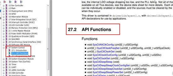

TM4C1294NCPDT芯片重启的函数是什么呢?
Other Parts Discussed in Thread: TM4C1294NCPDT
TM4C1294NCPDT芯片重启的函数是什么呢?  有人知道吗?

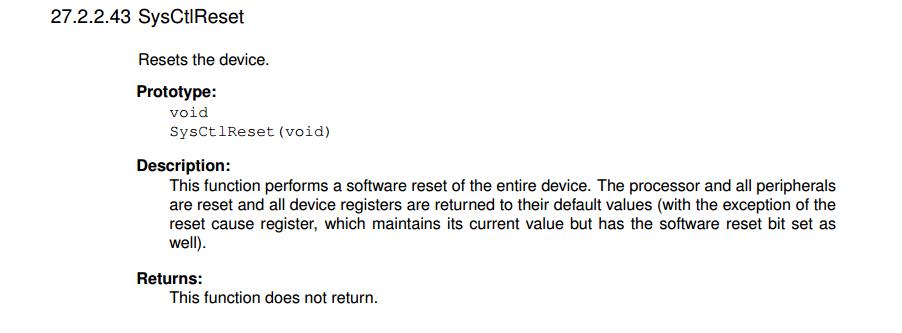

    //! Resets the device.
    //! This function performs a software reset of the entire device. The
    //! processor and all peripherals are reset and all device registers are
    //! returned to their default values (with the exception of the reset cause
    //! register, which maintains its current value but has the software reset
    //! bit set as well).
    //! \return This function does not return.
    void
    SysCtlReset(void)
    // Perform a software reset request. This request causes the device to
    // reset, no further code is executed.
    HWREG(NVIC_APINT) = NVIC_APINT_VECTKEY | NVIC_APINT_SYSRESETREQ;
    // The device should have reset, so this should never be reached. Just in
    // case, loop forever.
    while(1)

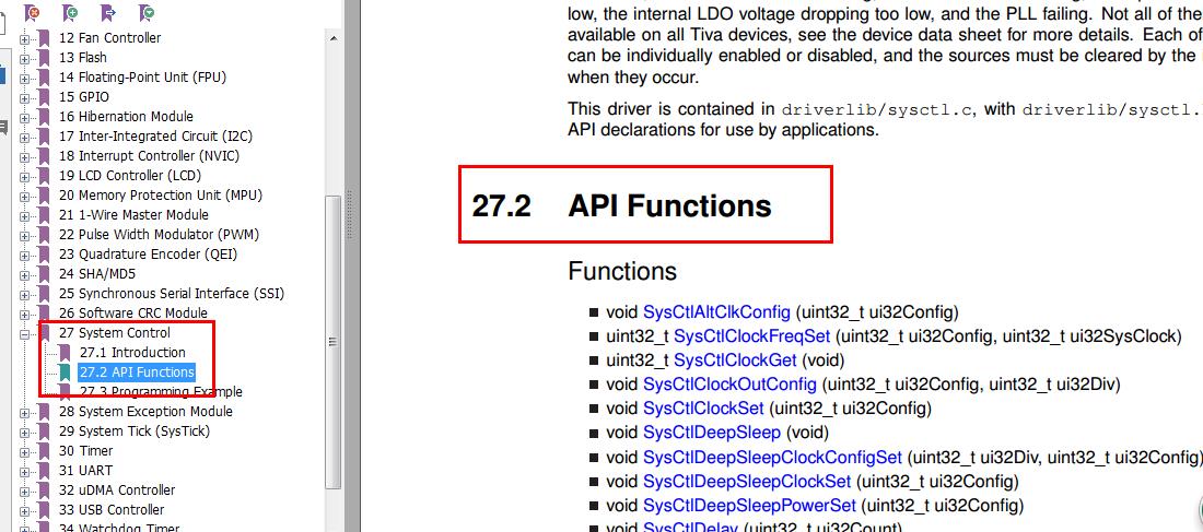

  • 芯片重启函数没有,楼主说的应该是复位函数。在库函数驱动手册27章那里有讲解
