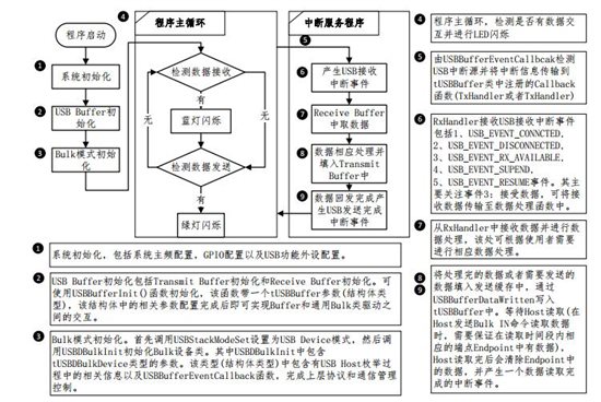

TM4C123x Bulk模式软件流程图
例子用的是官方TivaWare 提供的 usb_dev_bulk 实例
    源代码程序如下所示:

    //! \addtogroup example_list
    //! <h1>USB Generic Bulk Device (usb_dev_bulk)</h1>
    //! This example provides a generic USB device offering simple bulk data
    //! transfer to and from the host.  The device uses a vendor-specific class ID
    //! and supports a single bulk IN endpoint and a single bulk OUT endpoint.
    //! Data received from the host is assumed to be ASCII text and it is
    //! echoed back with the case of all alphabetic characters swapped.
    //! A Windows INF file for the device is provided on the installation CD and
    //! in the C:/ti/TivaWare-for-C-Series/windows_drivers directory of TivaWare C
    //! series releases.  This INF contains information required to install the
    //! WinUSB subsystem on Windowi16XP and Vista PCs.  WinUSB is a Windows
    //! subsystem allowing user mode applications to access the USB device without
    //! the need for a vendor-specific kernel mode driver.
    //! A sample Windows command-line application, usb_bulk_example, illustrating
    //! how to connect to and communicate with the bulk device is also provided.
    //! The application binary is installed as part of the ''Windows-side examples
    //! for USB kits'' package (SW-USB-win) on the installation CD or via download
    //! from http://www.ti.com/tivaware .  Project files are included to allow
    //! the examples to be built using Microsoft VisualStudio 2008.  Source code
    //! for this application can be found in directory
    //! TivaWare-for-C-Series/tools/usb_bulk_example.

    // Receive new data and echo it back to the host.
    // \param psDevice points to the instance data for the device whose data is to
    // be processed.
    // \param pui8Data points to the newly received data in the USB receive buffer.
    // \param ui32NumBytes is the number of bytes of data available to be processed.
    // This function is called whenever we receive a notification that data is
    // available from the host. We read the data, byte-by-byte and swap the case
    // of any alphabetical characters found then write it back out to be
    // transmitted back to the host.
    // \return Returns the number of bytes of data processed.
    static uint32_t
    EchoNewDataToHost(tUSBDBulkDevice *psDevice, uint8_t *pui8Data,
                      uint32_t ui32NumBytes)
        uint32_t ui32Loop, ui32Space, ui32Count;
        uint32_t ui32ReadIndex;
        uint32_t ui32WriteIndex;
        tUSBRingBufObject sTxRing;
        // Get the current buffer information to allow us to write directly to
        // the transmit buffer (we already have enough information from the
        // parameters to access the receive buffer directly).
        USBBufferInfoGet(&g_sTxBuffer, &sTxRing);
        // How much space is there in the transmit buffer?
        ui32Space = USBBufferSpaceAvailable(&g_sTxBuffer);
        // How many characters can we process this time round?
        ui32Loop = (ui32Space < ui32NumBytes) ? ui32Space : ui32NumBytes;
        ui32Count = ui32Loop;
        // Update our receive counter.
        g_ui32RxCount += ui32NumBytes;
        // Dump a debug message.
        DEBUG_PRINT("Received %d bytes\n", ui32NumBytes);
        // Set up to process the characters by directly accessing the USB buffers.
        ui32ReadIndex = (uint32_t)(pui8Data - g_pui8USBRxBuffer);
        ui32WriteIndex = sTxRing.ui32WriteIndex;
        while(ui32Loop)
            // Copy from the receive buffer to the transmit buffer converting
            // character case on the way.
            // Is this a lower case character?
            if((g_pui8USBRxBuffer[ui32ReadIndex] >= 'a') &&
               (g_pui8USBRxBuffer[ui32ReadIndex] <= 'z'))
                // Convert to upper case and write to the transmit buffer.
                g_pui8USBTxBuffer[ui32WriteIndex] =
                    (g_pui8USBRxBuffer[ui32ReadIndex] - 'a') + 'A';
            else
                // Is this an upper case character?
                if((g_pui8USBRxBuffer[ui32ReadIndex] >= 'A') &&
                   (g_pui8USBRxBuffer[ui32ReadIndex] <= 'Z'))
                    // Convert to lower case and write to the transmit buffer.
                        (g_pui8USBRxBuffer[ui32ReadIndex] - 'Z') + 'z';
                else
                    // Copy the received character to the transmit buffer.
                            g_pui8USBRxBuffer[ui32ReadIndex];
            // Move to the next character taking care to adjust the pointer for
            // the buffer wrap if necessary.
            ui32WriteIndex++;
            ui32WriteIndex = (ui32WriteIndex == BULK_BUFFER_SIZE) ?
                             0 : ui32WriteIndex;
            ui32ReadIndex++;
            ui32ReadIndex = (ui32ReadIndex == BULK_BUFFER_SIZE) ?
                            0 : ui32ReadIndex;
            ui32Loop--;
        // We've processed the data in place so now send the processed data
        // back to the host.
        USBBufferDataWritten(&g_sTxBuffer, ui32Count);
        DEBUG_PRINT("Wrote %d bytes\n", ui32Count);
        // We processed as much data as we can directly from the receive buffer so
        // we need to return the number of bytes to allow the lower layer to
        // update its read pointer appropriately.
        return(ui32Count);
    // Handles bulk driver notifications related to the transmit channel (data to
    // the USB host).
    // \param pvCBData is the client-supplied callback pointer for this channel.
    // \param ui32Event identifies the event we are being notified about.
    // \param ui32MsgValue is an event-specific value.
    // \param pvMsgData is an event-specific pointer.
    // This function is called by the bulk driver to notify us of any events
    // related to operation of the transmit data channel (the IN channel carrying
    // data to the USB host).
    // \return The return value is event-specific.
    uint32_t
    TxHandler(void *pvCBData, uint32_t ui32Event, uint32_t ui32MsgValue,
              void *pvMsgData)
        // We are not required to do anything in response to any transmit event
        // in this example. All we do is update our transmit counter.
        if(ui32Event == USB_EVENT_TX_COMPLETE)
            g_ui32TxCount += ui32MsgValue;
        DEBUG_PRINT("TX complete %d\n", ui32MsgValue);
        return(0);
    // Handles bulk driver notifications related to the receive channel (data from
    // the USB host).
    // related to operation of the receive data channel (the OUT channel carrying
    // data from the USB host).
    uint32_t
    RxHandler(void *pvCBData, uint32_t ui32Event,
                   uint32_t ui32MsgValue, void *pvMsgData)
        // Which event are we being sent?
        switch(ui32Event)
            // We are connected to a host and communication is now possible.
            case USB_EVENT_CONNECTED:
                g_bUSBConfigured = true;
                UARTprintf("Host connected.\n");
                // Flush our buffers.
                USBBufferFlush(&g_sTxBuffer);
                USBBufferFlush(&g_sRxBuffer);
                break;
            // The host has disconnected.
            case USB_EVENT_DISCONNECTED:
                g_bUSBConfigured = false;
                UARTprintf("Host disconnected.\n");
                break;
            // A new packet has been received.
            case USB_EVENT_RX_AVAILABLE:
                tUSBDBulkDevice *psDevice;
                // Get a pointer to our instance data from the callback data
                // parameter.
                psDevice = (tUSBDBulkDevice *)pvCBData;
                // Read the new packet and echo it back to the host.
                return(EchoNewDataToHost(psDevice, pvMsgData, ui32MsgValue));
            // Ignore SUSPEND and RESUME for now.
            case USB_EVENT_SUSPEND:
            case USB_EVENT_RESUME:
                break;
            // Ignore all other events and return 0.
            default:
                break;
        return(0);
    // Configure the UART and its pins.  This must be called before UARTprintf().
    void
    ConfigureUART(void)
        // Enable the GPIO Peripheral used by the UART.
        ROM_SysCtlPeripheralEnable(SYSCTL_PERIPH_GPIOA);
        // Enable UART0
        ROM_SysCtlPeripheralEnable(SYSCTL_PERIPH_UART0);
        // Configure GPIO Pins for UART mode.
        ROM_GPIOPinConfigure(GPIO_PA0_U0RX);
        ROM_GPIOPinConfigure(GPIO_PA1_U0TX);
        ROM_GPIOPinTypeUART(GPIO_PORTA_BASE, GPIO_PIN_0 | GPIO_PIN_1);
        // Use the internal 16MHz oscillator as the UART clock source.
        UARTClockSourceSet(UART0_BASE, UART_CLOCK_PIOSC);
        // Initialize the UART for console I/O.
        UARTStdioConfig(0, 115200, 16000000);
    // This is the main application entry function.
    int
    main(void)
        volatile uint32_t ui32Loop;
        uint32_t ui32TxCount;
        uint32_t ui32RxCount;
        // Enable lazy stacking for interrupt handlers.  This allows floating-point
        // instructions to be used within interrupt handlers, but at the expense of
        // extra stack usage.
        ROM_FPULazyStackingEnable();
        // Set the clocking to run from the PLL at 50MHz
        ROM_SysCtlClockSet(SYSCTL_SYSDIV_4 | SYSCTL_USE_PLL | SYSCTL_OSC_MAIN |
                           SYSCTL_XTAL_16MHZ);
        // Enable the GPIO port that is used for the on-board LED.
        ROM_SysCtlPeripheralEnable(SYSCTL_PERIPH_GPIOF);
        // Enable the GPIO pins for the LED (PF2 & PF3).
        ROM_GPIOPinTypeGPIOOutput(GPIO_PORTF_BASE, GPIO_PIN_3 | GPIO_PIN_2);
        // Open UART0 and show the application name on the UART.
        ConfigureUART();
        UARTprintf("\033[2JTiva C Series USB bulk device example\n");
        UARTprintf("---------------------------------\n\n");
        // Not configured initially.
        // Enable the GPIO peripheral used for USB, and configure the USB
        // pins.
        ROM_SysCtlPeripheralEnable(SYSCTL_PERIPH_GPIOD);
        ROM_GPIOPinTypeUSBAnalog(GPIO_PORTD_BASE, GPIO_PIN_4 | GPIO_PIN_5);
        // Enable the system tick.
        ROM_SysTickPeriodSet(ROM_SysCtlClockGet() / SYSTICKS_PER_SECOND);
        ROM_SysTickIntEnable();
        ROM_SysTickEnable();
        // Tell the user what we are up to.
        UARTprintf("Configuring USB\n");
        // Initialize the transmit and receive buffers.
        USBBufferInit(&g_sTxBuffer);
        USBBufferInit(&g_sRxBuffer);
        // Set the USB stack mode to Device mode with VBUS monitoring.
        USBStackModeSet(0, eUSBModeForceDevice, 0);
        // Pass our device information to the USB library and place the device
        // on the bus.
        USBDBulkInit(0, &g_sBulkDevice);
        // Wait for initial configuration to complete.
        UARTprintf("Waiting for host...\n");
        // Clear our local byte counters.
        ui32RxCount = 0;
        ui32TxCount = 0;
        // Main application loop.
        while(1)
            // See if any data has been transferred.
            if((ui32TxCount != g_ui32TxCount) || (ui32RxCount != g_ui32RxCount))
                // Has there been any transmit traffic since we last checked?
                if(ui32TxCount != g_ui32TxCount)
                    // Turn on the Green LED.
                    GPIOPinWrite(GPIO_PORTF_BASE, GPIO_PIN_3, GPIO_PIN_3);
                    // Delay for a bit.
                    for(ui32Loop = 0; ui32Loop < 150000; ui32Loop++)
                    // Turn off the Green LED.
                    GPIOPinWrite(GPIO_PORTF_BASE, GPIO_PIN_3, 0);
                    // Take a snapshot of the latest transmit count.
                    ui32TxCount = g_ui32TxCount;
                // Has there been any receive traffic since we last checked?
                if(ui32RxCount != g_ui32RxCount)
                    // Turn on the Blue LED.
                    GPIOPinWrite(GPIO_PORTF_BASE, GPIO_PIN_2, GPIO_PIN_2);
                    // Delay for a bit.
                    // Turn off the Blue LED.
                    GPIOPinWrite(GPIO_PORTF_BASE, GPIO_PIN_2, 0);
                    // Take a snapshot of the latest receive count.
                    ui32RxCount = g_ui32RxCount;
                // Update the display of bytes transferred.
                UARTprintf("\rTx: %d  Rx: %d", ui32TxCount, ui32RxCount);
