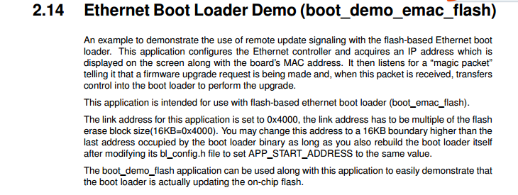

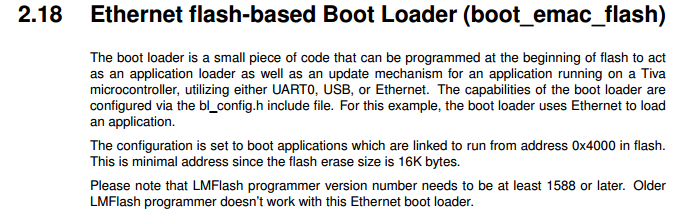

小弟最近拿到一块EK-TM41294的demo板,调试远程升级功能。
背景:
目前用Tivaware_C_Series-2.1.3.156 固件例子中的boot_serial程序可以实现串口升级。

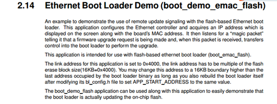

该目录下没有网口升级例子,于是在SW-DK-TM4C129X-2.1.3.156.exe 例程中找到boot_demo_emac_flash例子
把例子移植到Tivaware_C_Series-2.1.3.156,使用该库的驱动及对应库,可以编译生成bin程序,烧录进去后
可以看到板卡MAC和设置的IP,然后程序就一直在这个位置,使用LM flash program 配置成网络模式升级也失败,连接不上,不知道有没有人做过该例子?
贴上源码

网络配置如下:
// Perform the initialization steps required to start up the Ethernet controller
// and lwIP stack.
void
SetupForEthernet(void)
uint32_t ui32User0, ui32User1;
uint8_t pui8MACAddr[8];
// Configure SysTick for a 100Hz interrupt.
ROM_SysTickPeriodSet(g_ui32SysClock / TICKS_PER_SECOND);
ROM_SysTickEnable();
ROM_SysTickIntEnable();
// Get the MAC address from the UART0 and UART1 registers in NV ram.
ROM_FlashUserGet(&ui32User0, &ui32User1);
if((ui32User0 == 0xffffffff) || (ui32User1 == 0xffffffff))
// We should never get here. This is an error if the MAC address has
// not been programmed into the device. Exit the program.
UARTprintf("MAC Address Not Programmed!\n\r");
while(1)
// Convert the 24/24 split MAC address from NV ram into a MAC address
// array.
pui8MACAddr[0] = ui32User0 & 0xff;
pui8MACAddr[1] = (ui32User0 >> 8) & 0xff;
pui8MACAddr[2] = (ui32User0 >> 16) & 0xff;
pui8MACAddr[3] = ui32User1 & 0xff;
pui8MACAddr[4] = (ui32User1 >> 8) & 0xff;
pui8MACAddr[5] = (ui32User1 >> 16) & 0xff;
// Format this address into the string used by the relevant widget.
UARTprintf("MAC: %02X-%02X-%02X-%02X-%02X-%02X\n\r",
pui8MACAddr[0], pui8MACAddr[1], pui8MACAddr[2], pui8MACAddr[3],
pui8MACAddr[4], pui8MACAddr[5]);
// Remember that we don't have an IP address yet.
// usnprintf(g_pcIPAddr, SIZE_IP_ADDR_BUFFER, "IP: Not assigned");
UARTprintf("IP: Not assigned\n\r");
// Initialize the lwIP TCP/IP stack.
// lwIPInit(g_ui32SysClock, pui8MACAddr, 0, 0, 0, IPADDR_USE_AUTOIP);
lwIPInit(g_ui32SysClock, pui8MACAddr,0xC0A8010C ,0xFFFFFF0, 0xC0A80101 , IPADDR_USE_STATIC);
// Setup the device locator service.
// LocatorInit();
// LocatorMACAddrSet(pui8MACAddr);
// Start the remote software update module.
UARTprintf("SoftwareUpdateInit\n\r");
SoftwareUpdateInit(SoftwareUpdateRequestCallback);   //这句一直没有运行,不知道为什么
