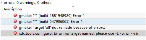

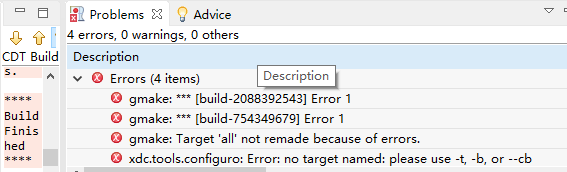

错误是这样的
js: "C:/ti/xdctools_3_32_01_22_core/packages/xdc/tools/Cmdr.xs", line 52: Error: xdc.tools.configuro: Error: no target named: please use -t, -b, or --cb
gmake: *** [build-547906065] Error 1
gmake: Target 'all' not remade because of errors.
**** Build Finished ****
Description Resource Path Location Type
gmake: *** [build-1881948929] Error 1 LAB2 C/C++ Problem
gmake: *** [build-547906065] Error 1 LAB2 C/C++ Problem
gmake: Target 'all' not remade because of errors. LAB2 C/C++ Problem
xdc.tools.configuro: Error: no target named: please use -t, -b, or --cb .xdchelp /LAB2 line 52 C/C++ Problem

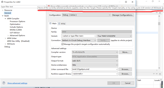

而且在properties中出现这个问题
上面写着:None of the currently selected products supplies value for the Target.Please specify the Target manually,or try using a pre-3.30 version of XDCtools.
try using a pre-3.30 version of XDCtools这个建议我也试过了
项目以前是使用ccs6.1.1开发的,编译器当时是用TI v5.2.7,TivaWare_C_Series-2.1.1.71
现在是用ccs6.2.0 编译器用TI v 5.2.9  TivaWare_C_Series-2.1.1.71一样
也已经试过重建创建文件,没有用,还是这个问题。
