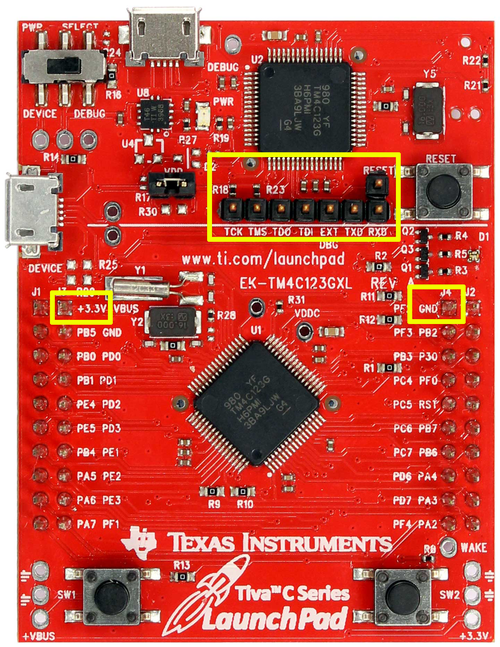

| TM4C123G LaunchPad | J-Link |
| TCK | Pin 9 (SWCLK / TCK) |
| TMS | Pin 7 (SWDIO / TMS) |
| TDO | Pin 13 (SWO / TDO) |
| TDI | Pin 5 (TDI) |
| RESET | Pin 15 (nRST) |
| 3.3V | Pin 1 (VTref) |
| GND | Pin 4 (GND) |
