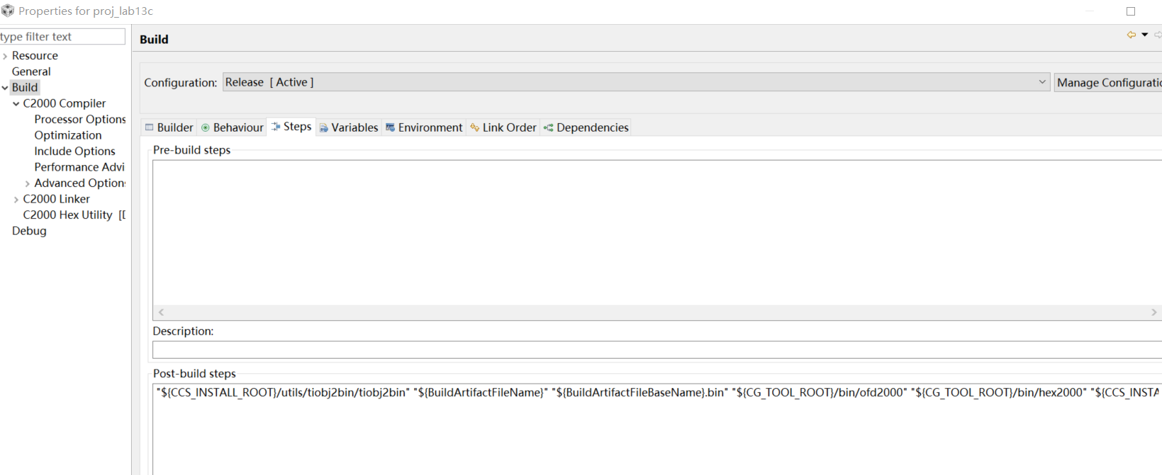

ccs6.2 生成bin文件,芯片为tms320f28069,应该如何设置?谢谢啦!
出现这个警告
"C:/ti/ccsv6/utils/tiobj2bin/tiobj2bin" "proj_lab13c.out" "proj_lab13c.bin" "C:/ti/ccsv6/tools/compiler/c2000_15.12.3.LTS/bin/ofd2000" "C:/ti/ccsv6/tools/compiler/c2000_15.12.3.LTS/bin/hex2000" "C:/ti/ccsv6/utils/tiobj2bin/mkhex4bin"
warning: section proj_lab13c.out(ramfuncs) at 07d0000h falls in unconfigured
memory (skipped)
配置如下图:
"${CCS_INSTALL_ROOT}/utils/tiobj2bin/tiobj2bin" "${BuildArtifactFileName}" "${BuildArtifactFileBaseName}.bin"
"${CG_TOOL_ROOT}/bin/ofd2000" "${CG_TOOL_ROOT}/bin/hex2000"
"${CCS_INSTALL_ROOT}/utils/tiobj2bin/mkhex4bin"
