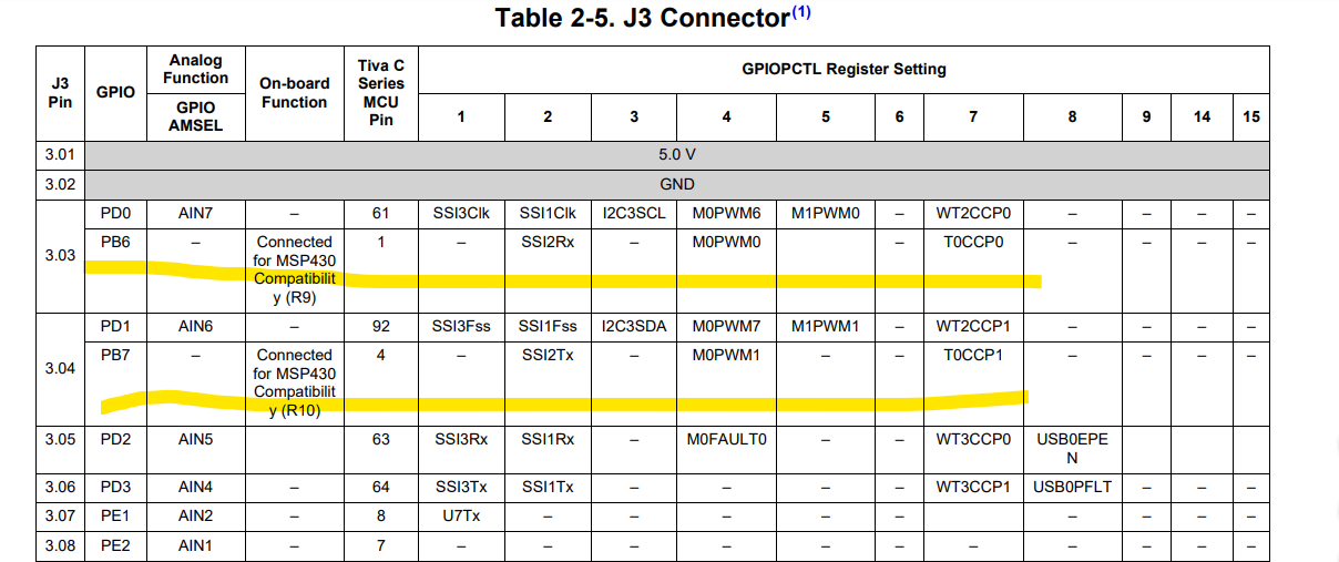

//配置相应的管脚
GPIOPinConfigure(GPIO_PB6_M0PWM0);
GPIOPinConfigure(GPIO_PB7_M0PWM1);
GPIOPinTypePWM(GPIO_PORTB_BASE,GPIO_PIN_6|GPIO_PIN_6|GPIO_PIN_7) ;
