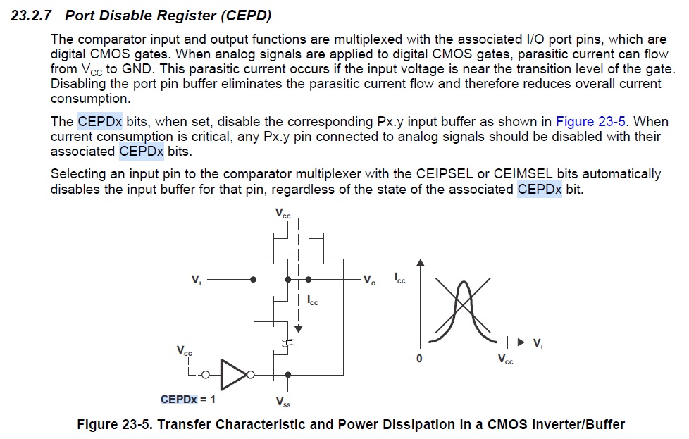

关于MSO432P4011处理器的 CEPD
请问TI工程师:
      这个CEPD如何设置  他的API设置函数在哪里?如何使用
  • 您可以直接操作寄存器,如下代码

    COMP_E0->CTL3 = BIT1;                   // Input Buffer Disable @P1.1/CE1
  • API的话,您可以使用

    //!       <br> Modified bits are \b CEPDx of \b CECTL3 register.
    //! This function sets the bit to disable the buffer for the specified input
    //! port to allow for analog signals from any of the comparator input pins. This
    //! bit is automatically set when the input is initialized to be used with the
    //! comparator module. This function should be used whenever an analog input is
    //! connected to one of these pins to prevent parasitic voltage from causing
    //! unexpected results.
    //! \return NONE
    extern void COMP_E_disableInputBuffer(uint32_t comparator,
            uint_fast16_t inputPort);
