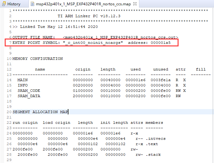

     我新导入一个例程:msp432p401x_1_MSP_EXP432P401R_nortos_ccs,Build后得到的*.map文件显示:
     ENTRY POINT SYMBOL: "_c_int00_noinit_noargs"  address: 000001a5
     怎样将_c_int00_noinit_noargs()的地址改为0x000000F0?

  • 这并非是我想问的,我想要的是:
    ENTRY POINT SYMBOL: "_c_int00_noinit_noargs" address: 000000F0
  • 我咨询了下国外工程师,回复如下
    By placing the c_int00 symbol first in the "preferred placement" list ("Build Settings->Linker->Advanced->Miscellaneous") it will be chosen first from the .text section for placement. Since .text follows .intvecs in the linker .cmd file, it will be placed immediately following the interrupt vector at 0xE8.
    If it absolutely must be placed at 0xF0, I suppose you could define an 8-byte dummy function and place that ahead of c_int00 in the list.
    I'll just mention here that _c_int00_noinit_noargs is not the entry point, in the sense of the first instruction executed, of the program. The "-e" option has no operational effect.
  • 非常感谢,这正是我所想要的。
