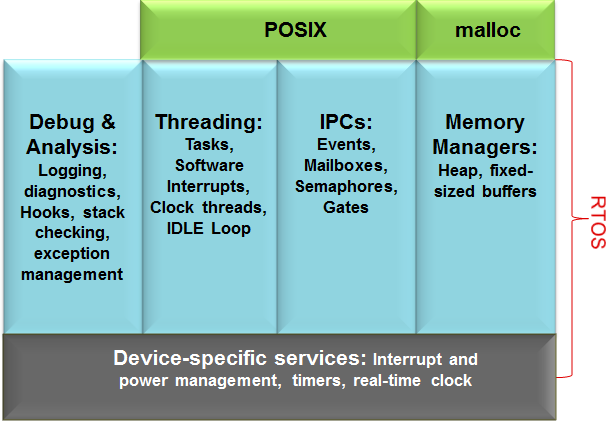

尊敬的工程师:
您好,我看到MSP432中关于网络的部分都使用了POSIX线程,这个POSIX线程是不是等同于我们SYS/BIOS的Task线程?我是不是都可以使用Task线程来替换这个POSIX线程,还是说这些网络的例程只能使用POSIX线程,谢谢!

POSIX is an IEEE industry API standard for OS compatibility. POSIX is not an RTOS. It resides on top of either TI-RTOS or FreeRTOS. As you can see with the following diagram, POSIX hides the underlying RTOS from the application.
SYS/BIOS also provides a subset of the POSIX thread (pthread) APIs. These include pthread threads,mutexes, read-write locks, barriers, and condition variables. The pthread APIs can simplify porting applications from a POSIX environment to SYS/BIOS, as well as allowing the same code to be compiled to run in a POSIX environment and with SYS/BIOS. As the pthread APIs are built on top of the SYS/BIOS Task and Semaphore modules, some of the POSIX APIs can be called from SYS/BIOS Tasks.
