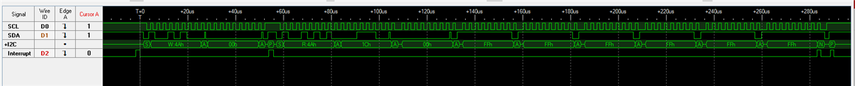

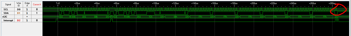

  • 我使用的是DK-TM4C129X进行测试,该套件通过I2C连接到TMP100温度传感器。尽管从温度传感器读取burst 信号并没有多大意义,但它足以显示I2C的功能。我使用FIFO和uDMA读取了8个字节。前两个字节是温度,后六个字节是0xFF。当我使用I2C_MASTER_CMD_FIFO_SINGLE_RECEIVE时,所有8个字节将以burst 方式读取,并且主机将在不确认最后一个字节(NACK)的情况下释放总线,并发送停止条件。
    当我使用I2C_MASTER_CMD_FIFO_BURST_RECEIVE_START时,结果是相同的,但是burst 读取在8个字节之后没有结束。
    尽管这不能解释您的代码中发生的情况,但显示了如何使用FIFO和uDMA正确进行burst 读取。我已附上我的项目以供参考。

  • 请您查看下面的回复。为了便于您更好理解,我以英文原文的形式给出:
     When using FIFO mode, each call to I2CMasterControl() can cause the reception or transmission of multiple bytes. Use of the uDMA extends the FIFO size.
    Using I2C_MASTER_CMD_FIFO_SINGLE_RECEIVE will cause a start, address, then read as many bytes as are programmed in the uDMA, with a NACK on the last byte and a stop condition. This is the example I showed you and I think what you want to do.
    Using I2C_MASTER_CMD_FIFO_BURST_RECEIVE_START will cause a start, address, then read as may bytes as are programmed in the uDMA acknowledging all bytes including the "last" one and not send a stop condition. (Shown in the second image of my previous post.)
    Using I2C_MASTER_CMD_FIFO_BURST_RECEIVE_FINISH will not generate a start or address, it will then read as may bytes as are programmed in the uDMA with a NACK on the last byte condition and a stop condition.
    So when you call I2CMasterControl() twice, once with I2C_MASTER_CMD_FIFO_BURST_RECEIVE_START and then with I2C_MASTER_CMD_FIFO_BURST_RECEIVE_FINISH, you have run the uDMA twice. If that is not what you want, don't do that!
