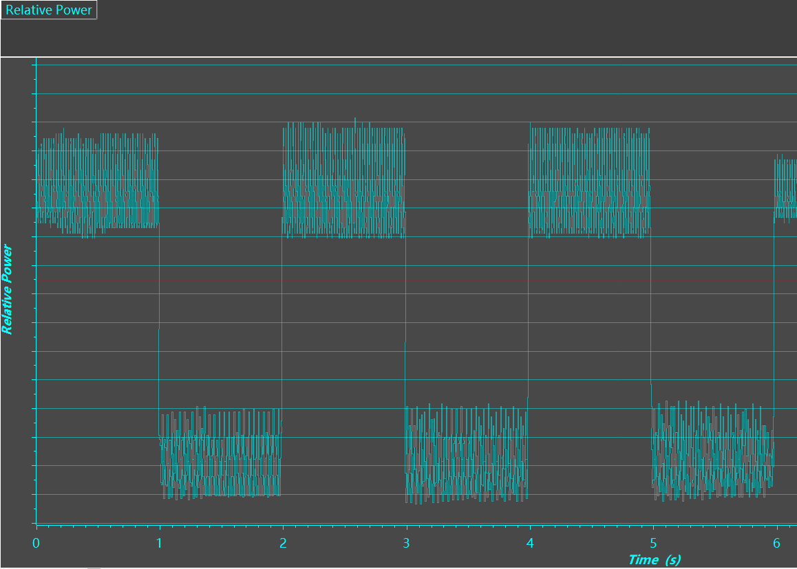

我这里ccs9.10里的energyTrace纵坐标没有刻度和单位,而我看的书上有标度还有单位,请问该怎么设置让他们显示出来呢?谢谢

This is expected.
For EnergyTrace+, during Energy and States capture mode, the debugger is constantly accessed, which continuously draws power. As a result, absolute power and energy readings would be misleading. Instead, the plots are shown by reference.
