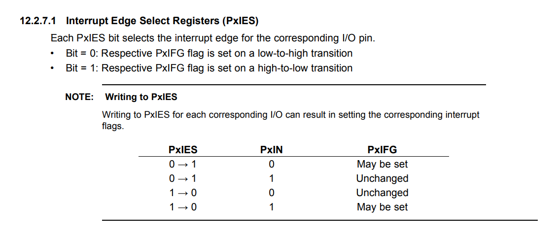

  • 目前例程中使用的是
    GPIO_interruptEdgeSelect ( uint_fast8_t  selectedPort,
    uint_fast16_t  selectedPin,
    uint_fast8_t  edgeSelect
    edgeSelect的值应为GPIO_LOW_TO_HIGH_TRANSITION或GPIO_HIGH_TO_LOW_TRANSITION
