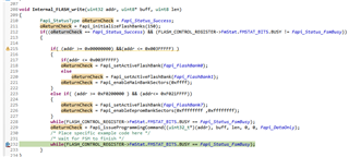

TMS570LC4357: 对FLASH读写,存在问题。
Part Number: TMS570LC4357
F021的库是:F021_API_CortexR4_BE_L2FMC_V3D16.lib

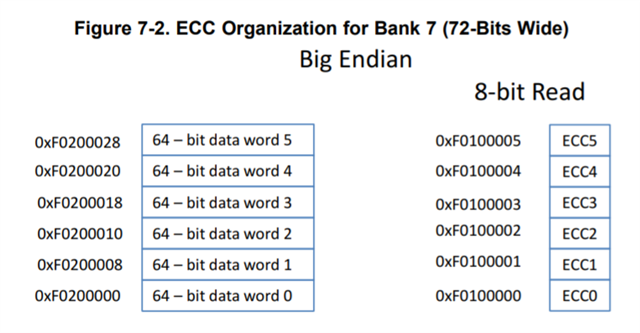

在对Fapi_FlashBank7 写时,如果数据长度不是8,就会写错误,Fapi_issueProgrammingCommand()报 Fapi_Error_AsyncIncorrectDataBufferLength。
如:
void Internal_FLASH_write(uint32 addr, uint8* buff, uint8 len)
Fapi_StatusType oReturnCheck = Fapi_Status_Success;
oReturnCheck = Fapi_initializeFlashBanks(150);
if((oReturnCheck == Fapi_Status_Success) && (FLASH_CONTROL_REGISTER->FmStat.FMSTAT_BITS.BUSY != Fapi_Status_FsmBusy))
if( (addr >= 0x00000000) &&(addr <= 0x003FFFFF) )
if(addr <= 0x003FFFFF)
oReturnCheck = Fapi_setActiveFlashBank(Fapi_FlashBank0);
else
oReturnCheck = Fapi_setActiveFlashBank(Fapi_FlashBank1);
oReturnCheck = Fapi_enableMainBankSectors(0xffff);
else if( (addr >= 0xF0200000 ) && (addr<= 0xF021FFFF))
oReturnCheck = Fapi_setActiveFlashBank(Fapi_FlashBank7);
oReturnCheck = Fapi_enableEepromBankSectors(0xffffffff ,0xffffffff);
while(FLASH_CONTROL_REGISTER->FmStat.FMSTAT_BITS.BUSY == Fapi_Status_FsmBusy);
oReturnCheck = Fapi_issueProgrammingCommand((uint32_t*)(addr), buff, len, 0, 0, Fapi_DataOnly);
/* Place specific example code here */
/* Wait for FSM to finish */
uint8 write_buff[16]={0x35,0x35,0x35,0x35,0x35,0x35,0x35,0x35,0x35,0x35,0x35,0x35,0x35,0x35,0x35,0x35};
Internal_FLASH_write(0xF0200000, write_buff, 16);
