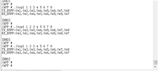

TMS570LS1227: 进行SPI数据DMA传输发现字节乱位
Part Number: TMS570LS1227
现在现象是发送数据为1,2,3,4,5,6,7,8,实际接收的数据为:2,1,4,3,6,5,8,7,,数据发生颠倒
代码如下:

#define SPI4_TX_ADDR ((uint32_t)(&(spiREG4->DAT1)) + 2)
#define SPI4_RX_ADDR ((uint32_t)(&(spiREG4->BUF)) + 2)
unsigned int BlockSize = 100;
unsigned short TX_DATA[100];
uint8 tx_test[8]={1,2,3,4,5,6,7,8};
uint8 rx_test[8]={0};
unsigned short RX_DATA[100] = {0};
unsigned int SPI4_HBCFlag = 0;

spiSendAndGetData(spiREG4, &dataconfig1_t, 16, TG0_TX_DATA, TG0_RX_DATA);
/********DMA***********************/
do
/* - enabling dma module */
dmaEnable();
/* Enable Interrupt after reception of data */
dmaEnableInterrupt(DMA_CH0, FTC); //Frame transfer complete
/* - assigning dma request: channel-0 with request line - 0/15 */
dmaReqAssign(DMA_CH1, 24); //Request line 24:SPI4 RX
dmaReqAssign(DMA_CH2, 25); //Request line 25:SPI4 TX
/* - configuring dma TX control packets */
dmaConfigCtrlTxPacket(tx_test, SPI4_TX_ADDR, 1, 4);
dmaSetCtrlPacket(DMA_CH2, g_dmaCTRLPKT_TX);
dmaConfigCtrlRxPacket(SPI4_RX_ADDR,rx_test, 1, 4);
dmaSetCtrlPacket(DMA_CH1, g_dmaCTRLPKT_RX);
/* - setting the dma channel to trigger on h/w request */
dmaSetChEnable(DMA_CH1, DMA_HW); //SPI1 RX, hardware triggering
dmaSetChEnable(DMA_CH2, DMA_HW); //SPI3 TX, hardware triggering
spiREG4->GCR1 = (spiREG4->GCR1 & 0xFFFFFFFFU) | (0x1 << 24); //Enable SPI
spiREG4->INT0 = (0x1 << 16); //SPI_DMAREQ; Enable DMA REQ only after setting the SPIEN bit to 1.

void dmaConfigCtrlRxPacket(uint32 sadd, uint32 dadd, uint16 ElmntCnt, uint16 FrameCnt)
g_dmaCTRLPKT_RX.SADD = sadd; /* source address */
g_dmaCTRLPKT_RX.DADD = dadd; /* destination address */
g_dmaCTRLPKT_RX.CHCTRL = 0; /* channel control */
g_dmaCTRLPKT_RX.FRCNT = FrameCnt; /* frame count */
g_dmaCTRLPKT_RX.ELCNT = ElmntCnt; /* element count */
g_dmaCTRLPKT_RX.ELDOFFSET = 0; /* element destination offset */
g_dmaCTRLPKT_RX.ELSOFFSET = 0; /* element destination offset */
g_dmaCTRLPKT_RX.FRDOFFSET = 0; /* frame destination offset */
g_dmaCTRLPKT_RX.FRSOFFSET = 0; /* frame destination offset */
g_dmaCTRLPKT_RX.PORTASGN = 4; /* port b */
g_dmaCTRLPKT_RX.RDSIZE = ACCESS_16_BIT; /* read size */
g_dmaCTRLPKT_RX.WRSIZE = ACCESS_16_BIT; /* write size */
g_dmaCTRLPKT_RX.TTYPE = FRAME_TRANSFER; /* transfer type */
g_dmaCTRLPKT_RX.ADDMODERD = ADDR_FIXED; /* address mode read */
g_dmaCTRLPKT_RX.ADDMODEWR = ADDR_INC1; /* address mode write */
g_dmaCTRLPKT_RX.AUTOINIT = AUTOINIT_ON; /* autoinit */
//DMA发送数据初始化
void dmaConfigCtrlTxPacket(uint32 sadd, uint32 dadd, uint16 ElmntCnt, uint16 FrameCnt)
g_dmaCTRLPKT_TX.SADD = sadd; /* source address */
g_dmaCTRLPKT_TX.DADD = dadd; /* destination address */
g_dmaCTRLPKT_TX.CHCTRL = 0; /* channel control */
g_dmaCTRLPKT_TX.FRCNT = FrameCnt; /* frame count */
g_dmaCTRLPKT_TX.ELCNT = ElmntCnt; /* element count */
g_dmaCTRLPKT_TX.ELDOFFSET = 0; /* element destination offset */
g_dmaCTRLPKT_TX.ELSOFFSET = 0; /* element destination offset */
g_dmaCTRLPKT_TX.FRDOFFSET = 0; /* frame destination offset */
g_dmaCTRLPKT_TX.FRSOFFSET = 0; /* frame destination offset */
g_dmaCTRLPKT_TX.PORTASGN = 4; /* port b */
g_dmaCTRLPKT_TX.RDSIZE = ACCESS_16_BIT; /* read size */
g_dmaCTRLPKT_TX.WRSIZE = ACCESS_16_BIT; /* write size */
g_dmaCTRLPKT_TX.TTYPE = FRAME_TRANSFER; /* transfer type */
g_dmaCTRLPKT_TX.ADDMODERD = ADDR_INC1; /* address mode read */
g_dmaCTRLPKT_TX.ADDMODEWR = ADDR_FIXED; /* address mode write */
g_dmaCTRLPKT_TX.AUTOINIT = AUTOINIT_ON; /* autoinit */
